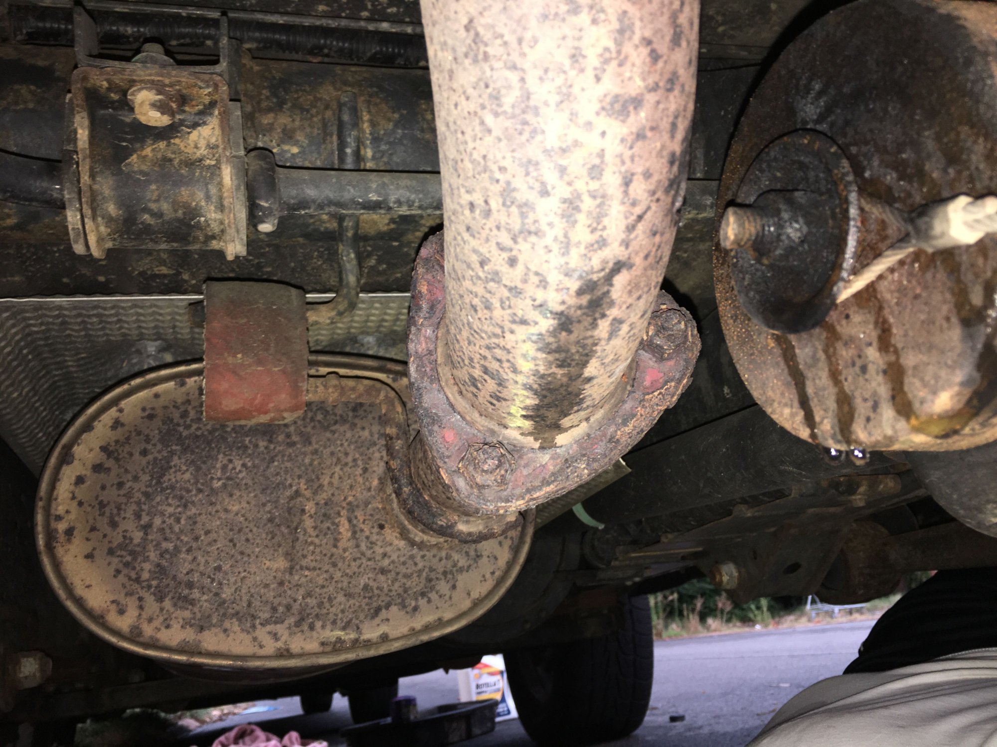

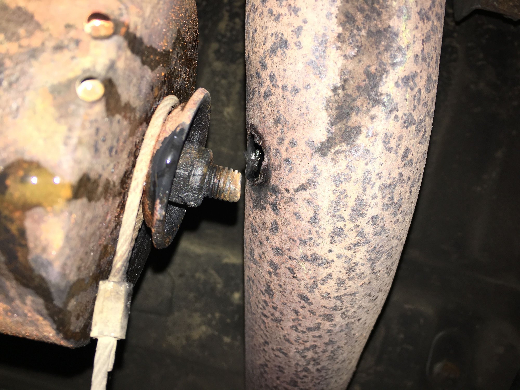

I found the source of the exhaust noise!
A hole in the exhaust pipe, likely caused over the weekend while I was hauling that big work trailer a thousand miles, moving my family. You can see that screw must have punctured it. I'm sure glad it's nothing more than a hole, it seems. I think I can have a welding shop fix that for cheap.
Found the solution on an EricTheCarGuy YouTube video on identifying exhaust leaks. Love that guy. Took me literally one minute to find the hole.
