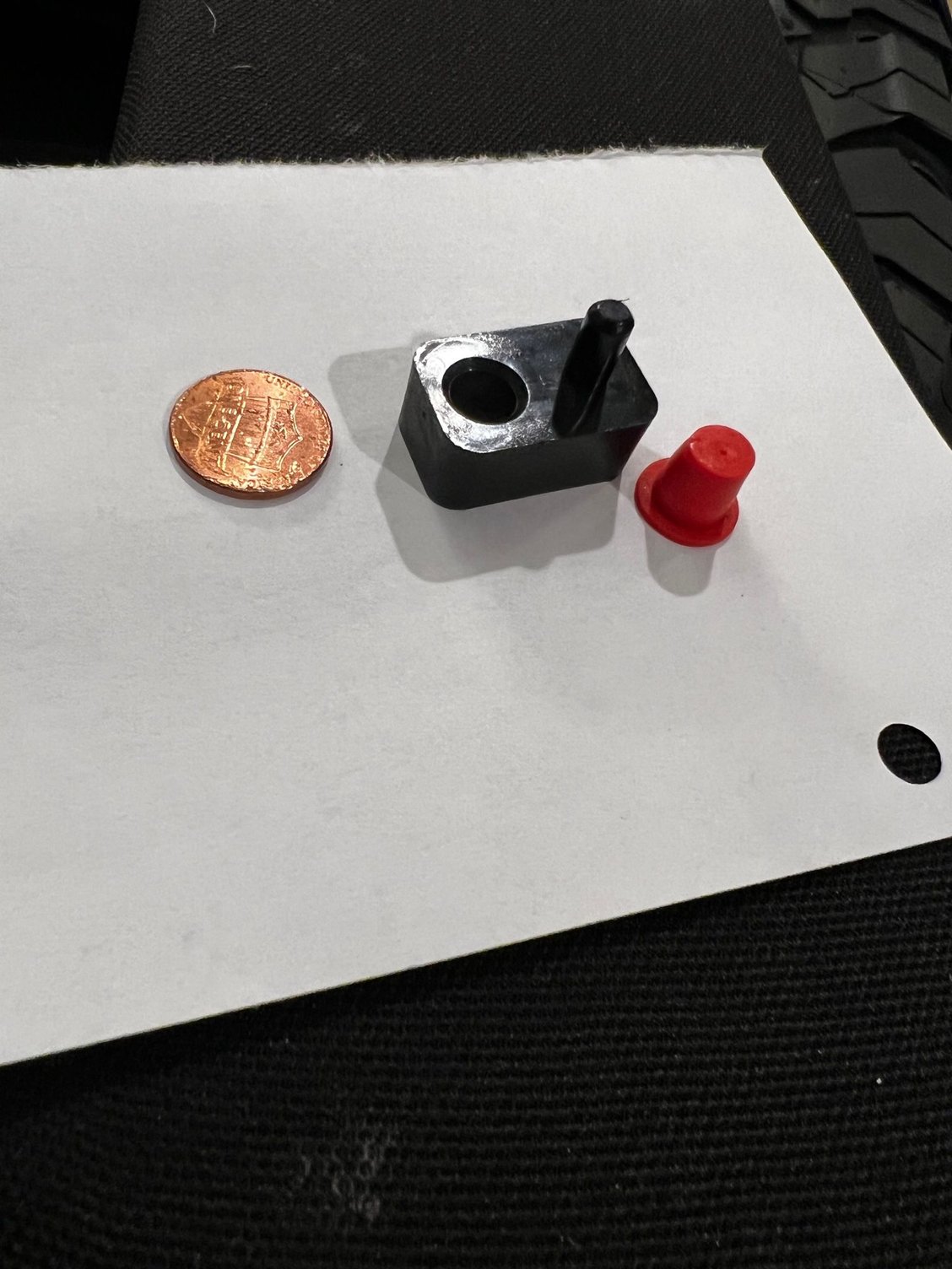

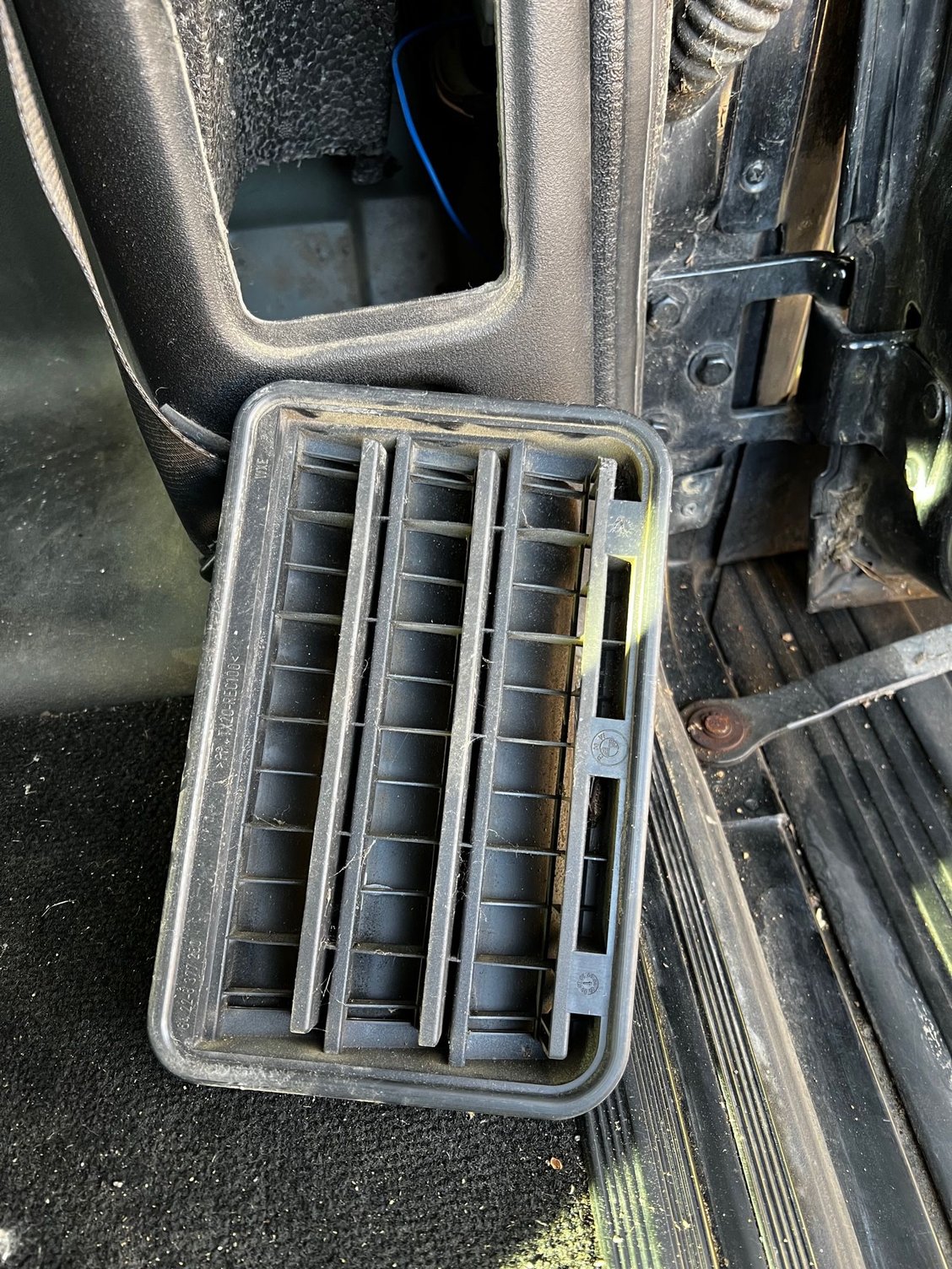

What are these parts? (2004 LR D2)
1) This "vent" was found behind the rear vent cargo trim cover panel. It says BMW on it.
2) Found on the floor in the back cargo area.
It says "BMW" on it.
Penny for size.

1. Is a one way flapper valve to let air out of your car (when hvac fan is pumping air in the car, it needs a place to exit). It fits in the hole that you see in the same photo.

The second part is a spacer that goes behind the cargo area trim panels at the grab handles when it is a 7 pass.
