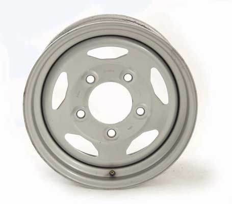

I have a 2002 D2 with 18" wheels. thinking of grabbing a set of 16" wheels to put larger tires on after my 2" lift. I see 16" wheels off of D2's, D1's and even back to 1994-1998.
If I am looking for a set of these, what years will fit my 2002 D2?
Also, what wheel is this? What's it called?

All DII wheels 1999 to 2004 will fit. Also Range Rover P38 will fit as well.
For the steel wheels give the guys at Lucky 8 a call

OK, so no D1 wheels. All P38's. Thanks.

No D1's they had a much larger lug pattern

The wheels you pictured are called Mirage.

95-02 P38 & 99-04 D2 = same bolt pattern.
