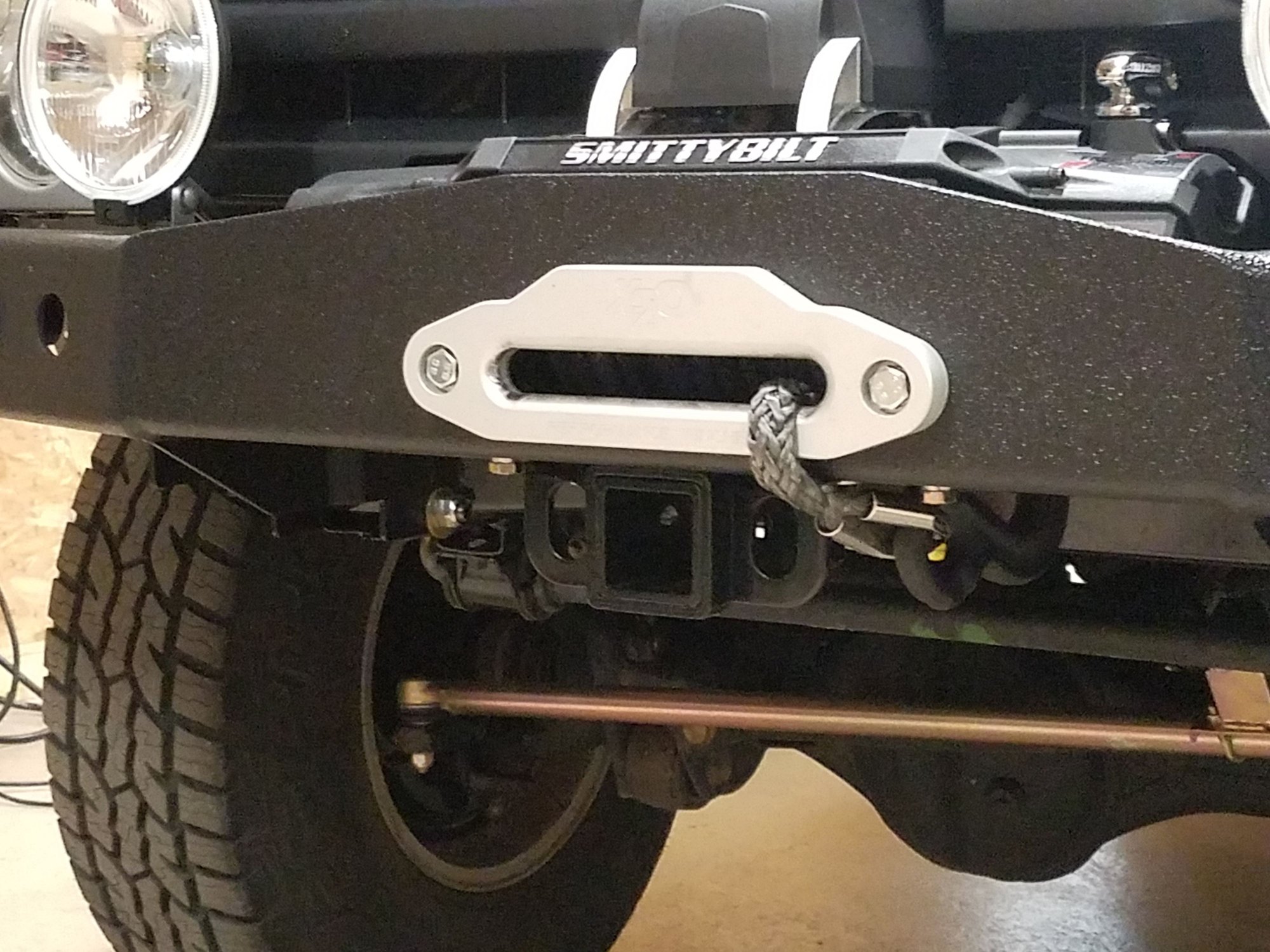

personally i do not like the slop you get using factory hardware so i upgraded the bolts in my bumper using 1/2 grade 8 hardware its a tight fit but it works and makes for a much tighter fitting bumper.
I fit a 2 inch receiver under the winch plate again using 1/2 inch grade 8 bolts, and use a receiver mounted d ring
i do not think the disco has the strongest setup for mounting a bumper, but if you are able to pull the four sleeved bolts out of the frame you did something incorrect. You might consider running an extra mounting point further back on the frame for additional support.
