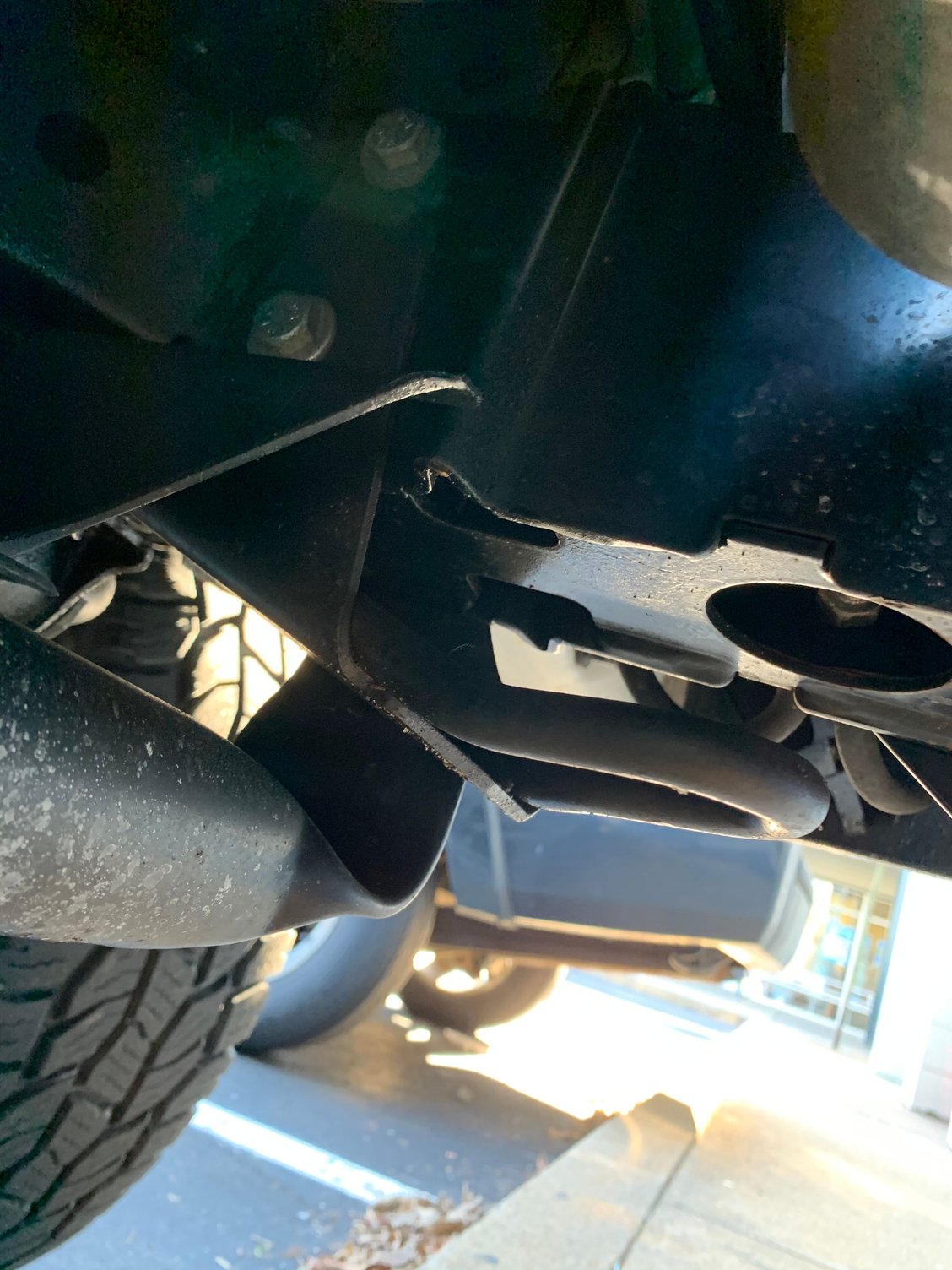

Not sure about the extra support. The PO installed the ARB bumper but I know it’s only a couple years old. I’ll attach some pictures and see if it has the supports:

That hook is a factory tow point. A lot of folks end up tossing that when they put on steel bumpers.
That should suffice for towing and winching needs. I don't know how I'd feel about using it for ****** recovery.

In the second picture it looks like you have the 45 deg piece.
But you also have the stock recovery loop under there.
You could hook up to that as an additional recovery point I have been winched up a pretty nasty rock river bed using that point.

Is the area that the bumper is attached to the Crash Cans?

@Micmac yup the stock crash cans are replaced and Arb one installed
