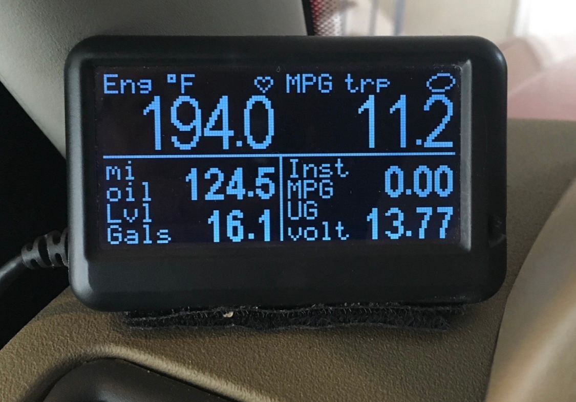

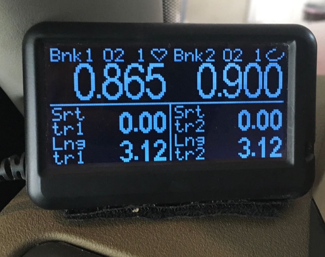

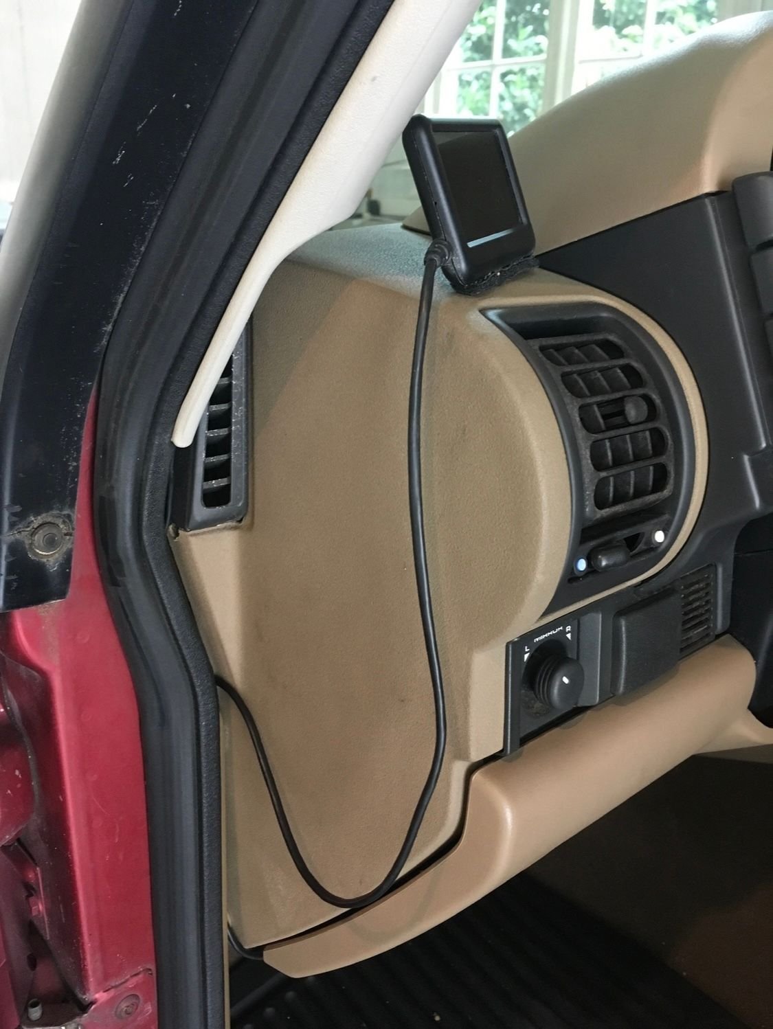

My UltraGauge mount is very, very simple. It sits on a strip of Velcro to the left of the instrument cluster, and leans against the A-pillar. Pics below show my setup. I have two pages set up as shown, and they cycle automatically every few seconds. I left an extra U-shaped loop of the cable hanging as pictured to make it easy to grab the UG to manipulate the buttons on the back, to reset the trip gauge after a fuel fill up for example.
