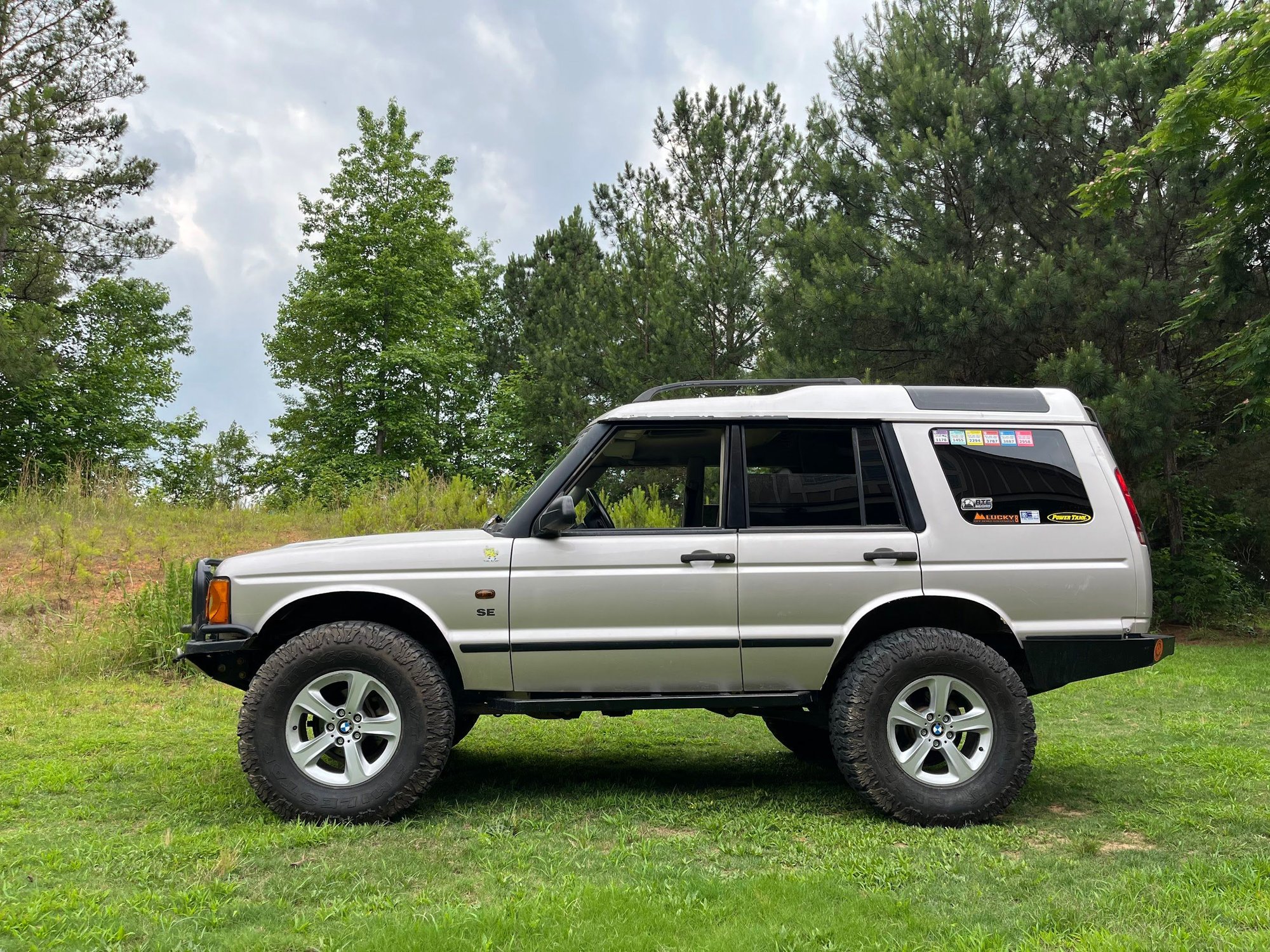

Wheels - BMW Style 137s
Bolt pattern - 5x120
Offset - +47
Size - 17x8 inch
Tires - 315/70 R17 (Milestar Patagonias)
Rubbing - Lots of it. Only in the front through, rear tucks fine
Modifications - 2" lift, 2" wheel spacers (in the pics is 2", I have 1.5" ones now to limit fender rub), cut fenders
Images:
