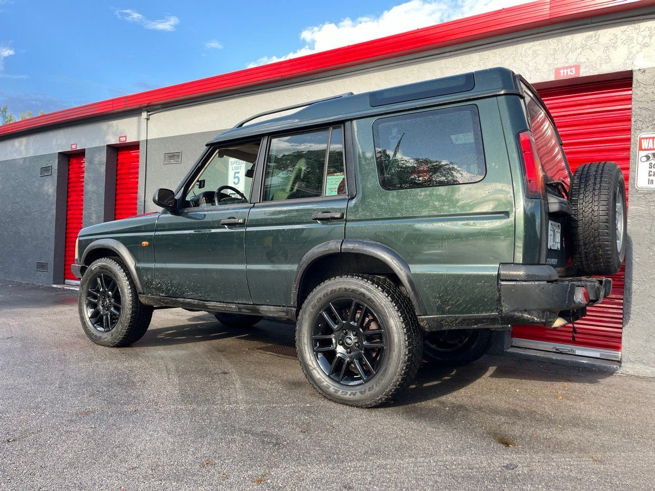

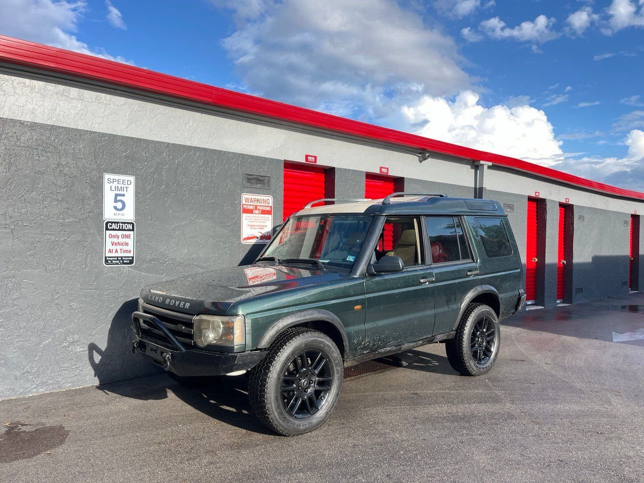

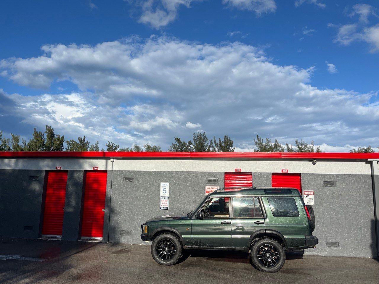

I have 19" wheels off a 2022 Defender. Tires are 255/65r19, they are basically 32" tires. I think this set up is the most you might want to install on a Disco II. With an off-road front bumper, they fit without even a lift in the front, they don't rub on anything. So far, I have a 2" lift on the rear only.
I kind of wish these tires were 1" smaller.
