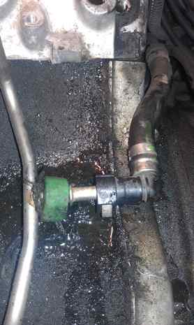

This is holding the intake on, how do I get it off? I figured I would ask before I broke something. It is close to the fire wall coming from the passenger side onto the back of the lower half of the intake. Thanks again...

This is called a "fuel line". You should be able to press the gray part of the plug in and push the connector off the stainless line. Do not force it!!!! It should come off easy. Just start "squeezeing" that connector and you will figure it out. As I said before......DO NOT FORCE IT!

Okay thanks Boris, I'm glad I stopped and took the picture and asked. I (being the blonde I am) was prying on the grey part but decided to stop and ask. Your answer is much appreciated. What if any issues have you had with your 03?
