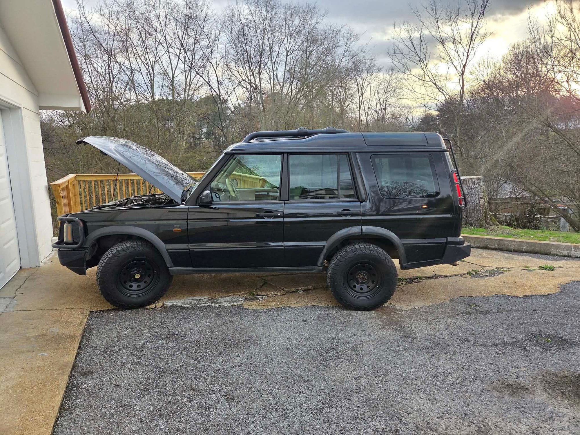

Good evening all,
I've just purchased my 2004 Disco. It has a 4.0L Bosch engine swapped into it by the previous owner. I'm intending to LS swap it as soon as possible. I've noticed this sort of whining noise that tracks with the increase/decrease of the RPMs additionally I found a permanent DTC for 4th gear ratio incorrect. The car will also stall out when its up to temp and I stop at signs or lights or when I go to reverse out of parking spots. but all eccessories remain on. I'm thinking the torque converter is kaput and possibly 4th gear itself or the related sensor. This is my first disco but not my first rodeo, I have just never heard this sound before and want to confirm whether it's just a Disco sound or something nefarious, there is also the tapping noise that I assume is a lifter failing. Attached should be the video and a picture of the disco. Thanks!
