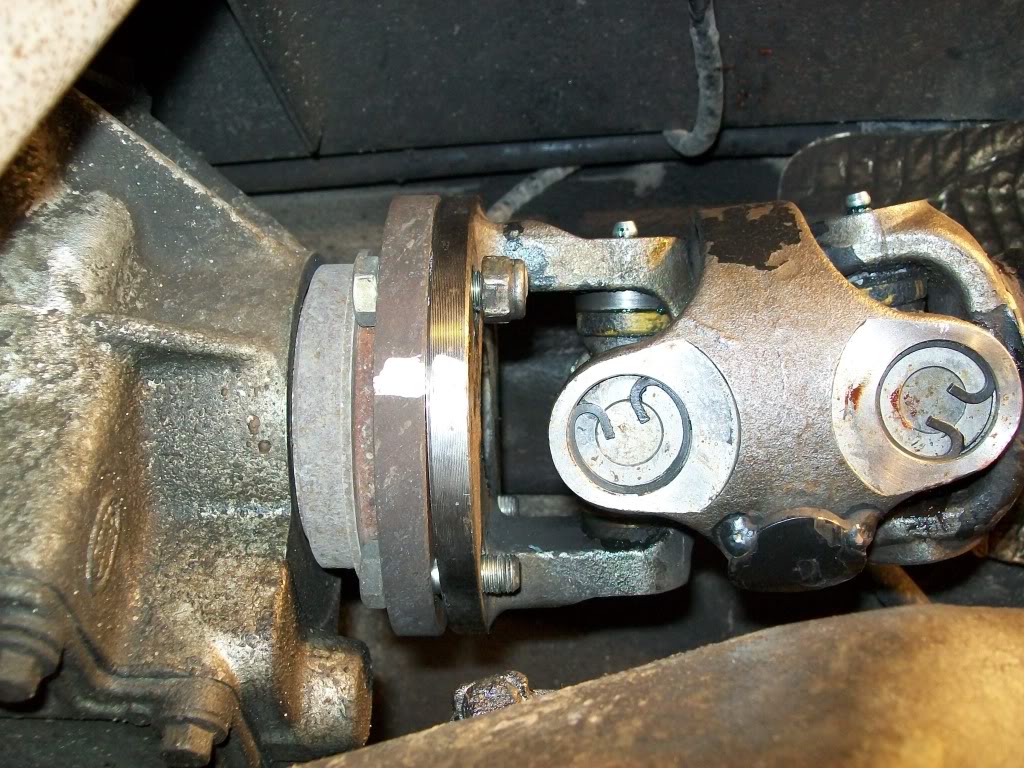

First thing is first mark the shaft where/how it was connected so you put it back on the same way you had it before. I use Wite-Out as you can see from the picture:

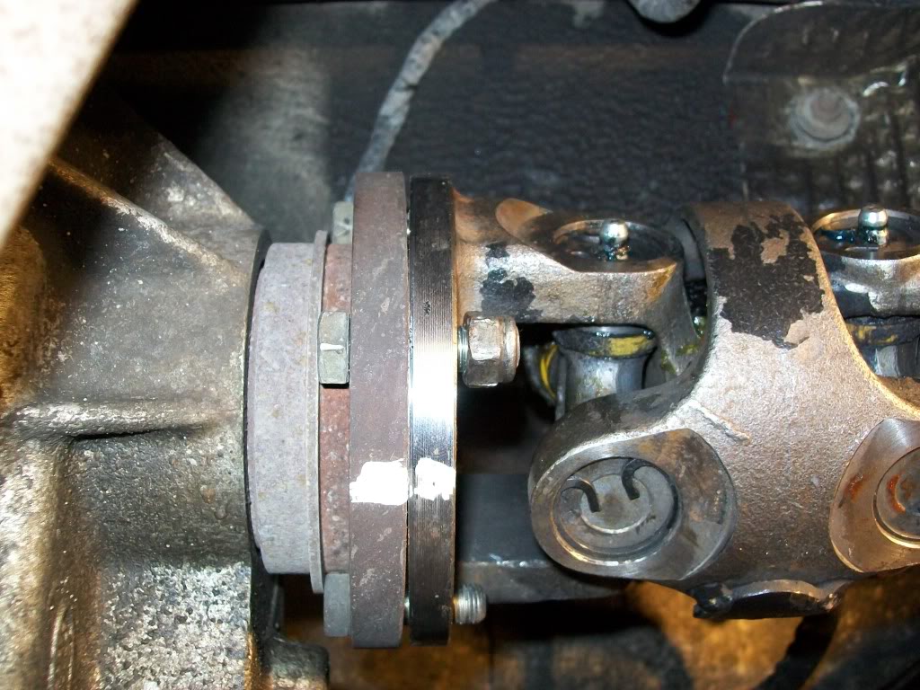

You will only be able to take 2 nuts off at one time, then just in the truck and place the t-case in "N" so you can rotate the shaft, then put in back in HI so it will stay still while you take the other 2 bolts off.
Then pull the shaft off the t-case side and let it rest on the cross brace:

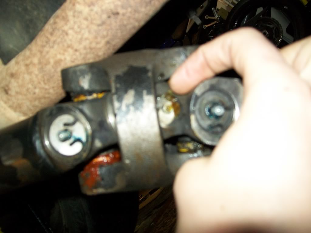

Then rotate the shaft until you see this female fitting, my finger is pointing right at it:

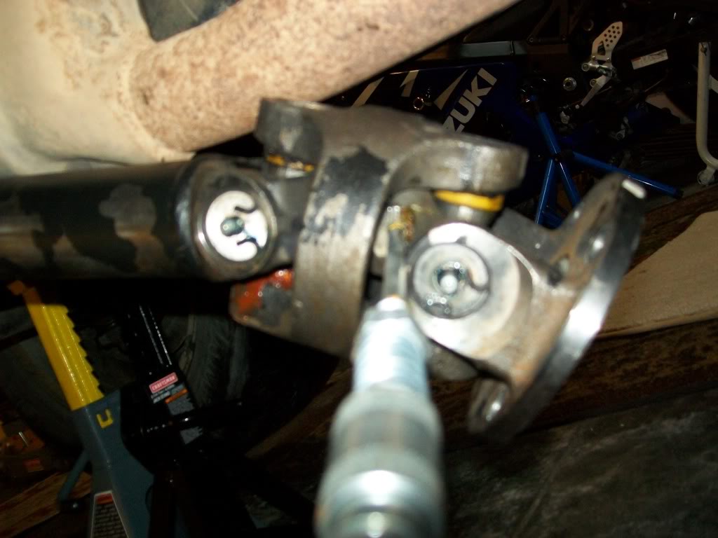

Then put the needle type tip on the grease gun and pump it a few times until you can see grease come out:

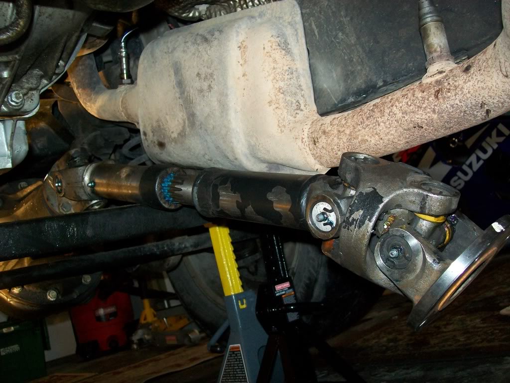

Then put in back together using the markings you used:
