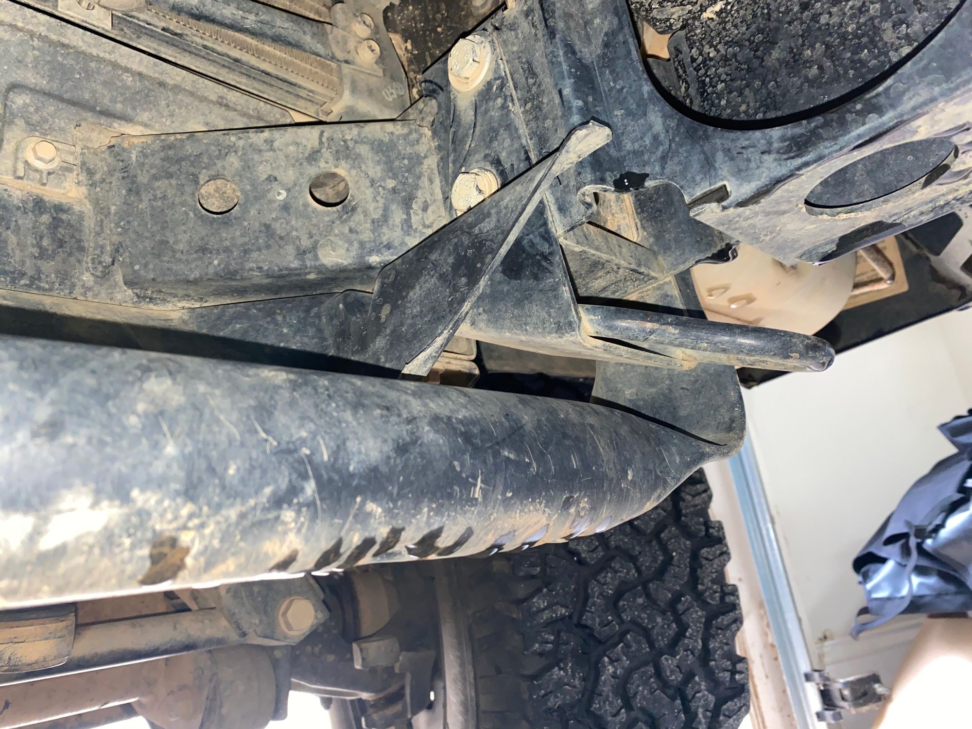

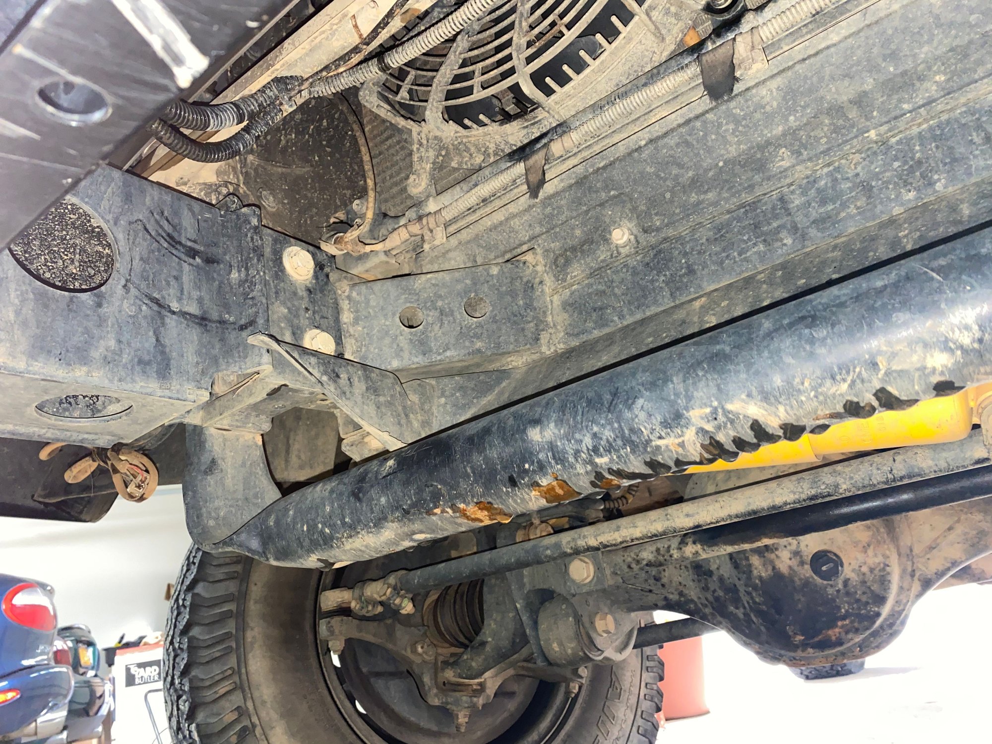

One other thing I noticed in the pics. You still have that OEM front bumper lower support installed, you don't need that with any aftermarket bumper. It was there to support the plastic OEM bumper/spoiler to keep it from crushing itself up into the steering. With that removed you will have more bite with the new bolts, and lock nuts to keep it tightly mounted.
