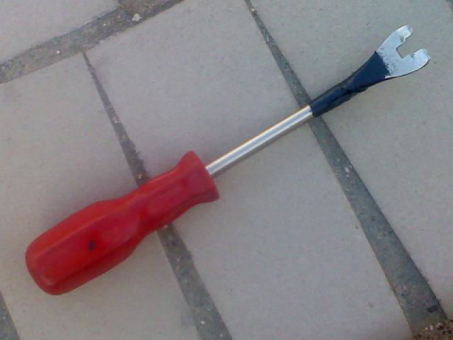

Next time use one of these to remove the door panel.
