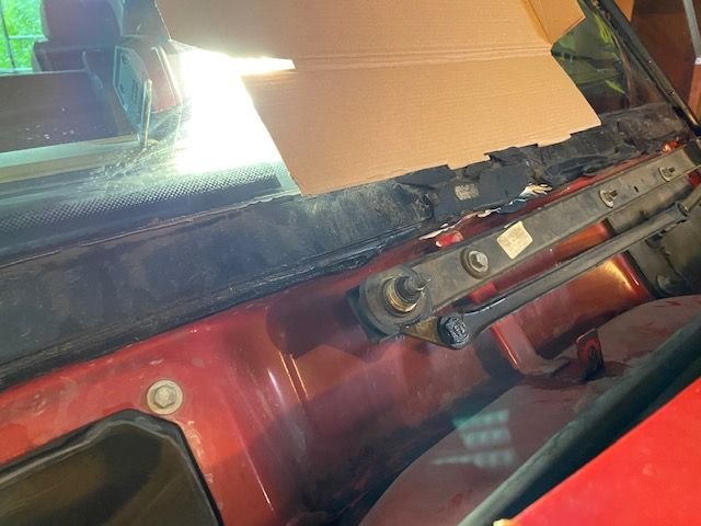

Just to follow up, I think I've got it solved unless something very bizarre is happening. I removed the lower windshield cowl (pretty easy per the AB video) mine had a bolt in the center that they didn't talk about, but it was easy enough to figure out and remove. To find the suspected gaps I put my light inside pointed towards the gap between the windshield and the dash. I then slid a piece of cardboard along the lower edge of the windshield and looked for where light shined through. As I suspected there was a large gap about 6" long in the center along with a few other much smaller gaps. I used a tube of DAP window sealant because a) it's what I had in the garage and b) it comes in a small flexible tube which let me get the nozzle down and around to where it needed to go. I was also able to do the D1 wiper retrofit while I was at it, so that was a bonus.
The sealant applies as white, you can see where I put it on in the center. All that space was just an open gap to the inside.

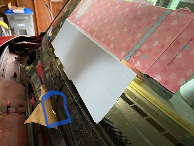

The "technique." Flashlight inside pointing down with a piece of cardboard taped to the windshield to block the light from my eyes. I then slid a small piece of cardboard along the bottom and look for light, as you can see circled in blue.
