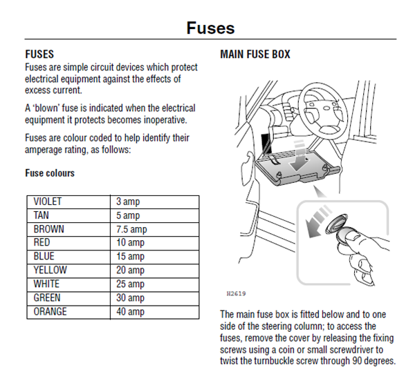

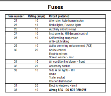

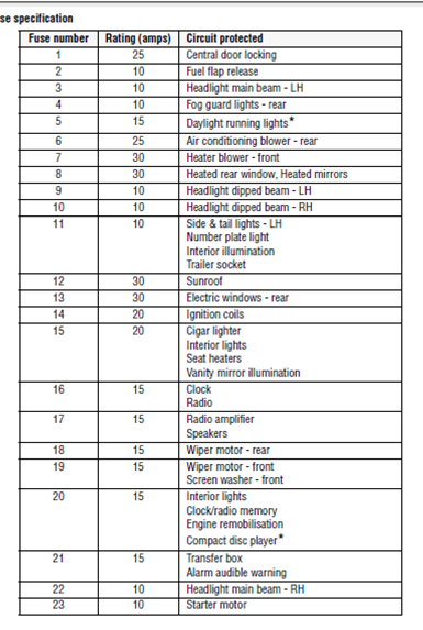

Fuse 19. 15 Amp. Hint. There are spare fuses in the bottom row of the fuse box from the factory. Also, pic of fuse box with fuse purpose noted in the emergency information section on the Owner's Handbook on page 188. Also, if there. Is a fuse #5, you can borrow it, as it is for the Day Time running lights, which are not programmed as such for those D2s in the US. I just replaced my front wiper motor. For completeness for the archives I have attached the interior fuse box/fuse panel layout from the owner's manual for the next poor soul who may need this, so they do not have to dig to find it in the manual.
