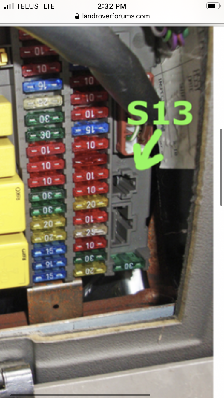

Can anyone who has done this provide direction ? I still want the A/C turn function but also the ability to fire it up "on demand"
you can use a wire from s13 terminal which is there already for a switched 12 bolts to a switch then directly to fan motor or go directly to the relay fan. I did this on my Subaru. I found if you energize the relay with a switch the ecu thinks there is something wrong. So you have to go to the line side of fan
I just used a spade connector to connect to the s13

@redwhitekat ah perfect thanks

might want to check to see if "fan ON" is a negative ground to relay before wiring a POS to it....

Late to the party but it's worth mentioning that when switching 12v to power the fan (it is continuous ground) you should include at minimum an inline fuse, and if you want to get nuts provide an additional relay with a fused circuit. As those fan motors rust/bind with long periods of non-use, they will draw more and more power to the point that things could get melty. A 25A fuse should be plenty. You might let the smoke out of the entire truck if you're not careful! ;)
