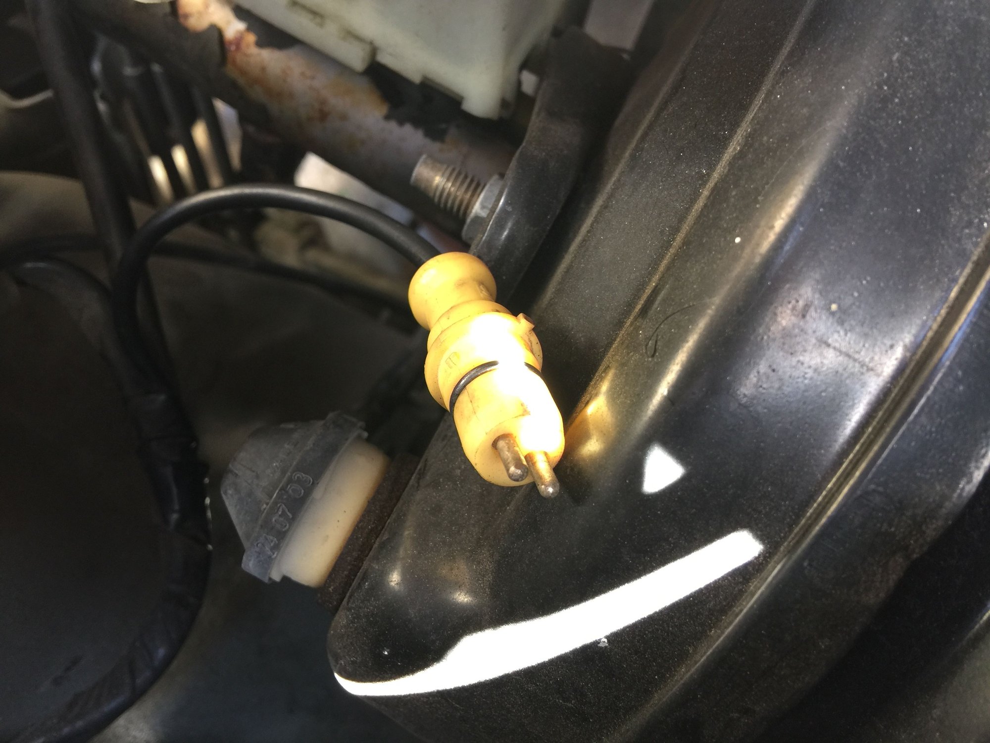

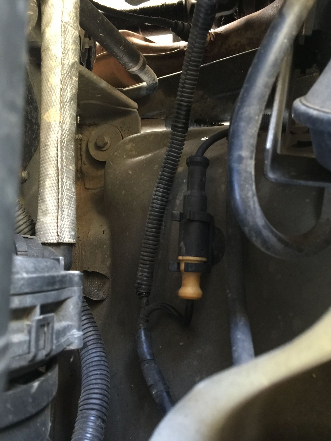

I recently have been getting the amigos popping up at random times, I'm thinking maybe this wire has something to do with it. Can anytime tell me what it is and why the drivers side isn't attached? The passenger side is the pic that is connected.

That is the ABS connection plug.
But at some time in the passed an new ABS sensor or hub assembly with the new longer wire that gets solder right to the Wabco ABS module may have been installed.
Trace the wire on the ABS sensor from the hub near that plug and see if it goes all the way to the passenger side wheel well kick panel.

I believe you are right sir. After looking for the wire coming from the wheel through the fender well, I noticed that it is now running through the firewall. I appreciate the response, I guess I'll give changing the shutter valves a shot.

Yes, that wire is the end of an ABS sensor which has been replaced, leaving the old one in place. Looks like the PO tried to fix the Amigos?

dont worry about it 9 out 10 discovery have that same plug empty
