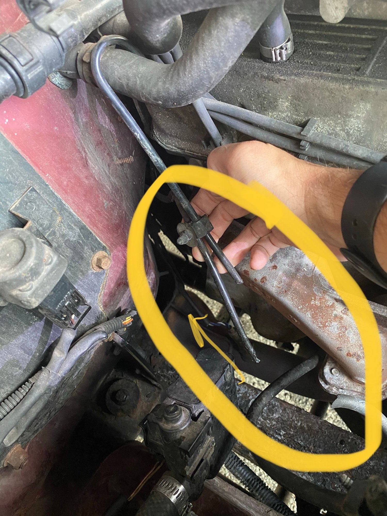

Hi. Tried finding a diagram of wires etc so I can answer my own question. Google images. No luck.
I do know my cc does not work. Light happens. Is this the vacuum line?
or something else. Seems as if it goes in that general direction, towards breaks. Have to follow it.
any help I would appreciate.
thanks

Breather tubes for the t-case and trans.

The vacuum lines for the cruise control are completely and solely attached to the cruise control unit itself. They don't connect to anything else. The engine vacuum lines are totally separate.

Follow line from beside the throttle cable towards the passenger (NAS) fender.
