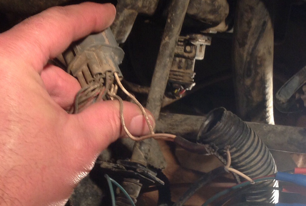

Long story short, a bunch of wiring got severed while wheeling. There are two plugs by the main fuse panel under the hood, one orange, one grey. My issue is the grey plug, it has two sheathed wires(plus others) going to it, inside each are two plain white wires, my dilemma is.... they are cut and i don't know which goes to which. Anyone know what they are? Does it matter which way they get connected back(assuming it does). My computer containing the manual has crashed and i only have an ipad that won't handle the info. Image attached.( i think! Lol)
Any help is appreciated.

It is hard to tell from the pic. Can you insert some arrows in the pics to point to the wires in question?

I wish i could but using an ipad, you can see the two wires in a y near the top right of the picture right near the plastic shroud. I will try to take a better pic of where the go into the plug as well.

Hopefully that picture will help more.

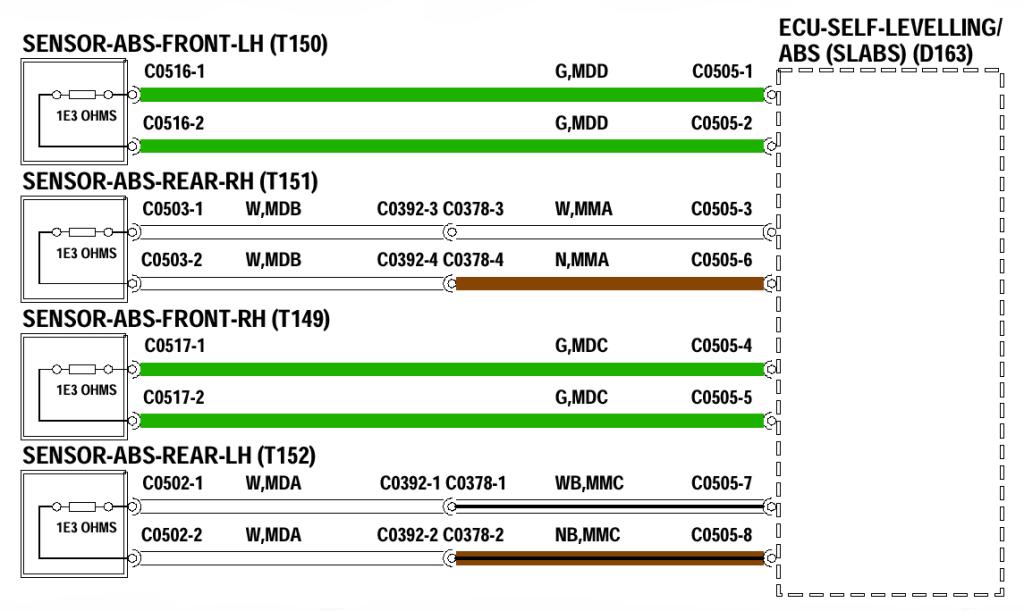

The White wires are your ABS wiring to the rear wheel sensors.
The wires to each wheel sensor are a twisted pair, which are over-sleeved.
Here's an extract from the wiring diagram -

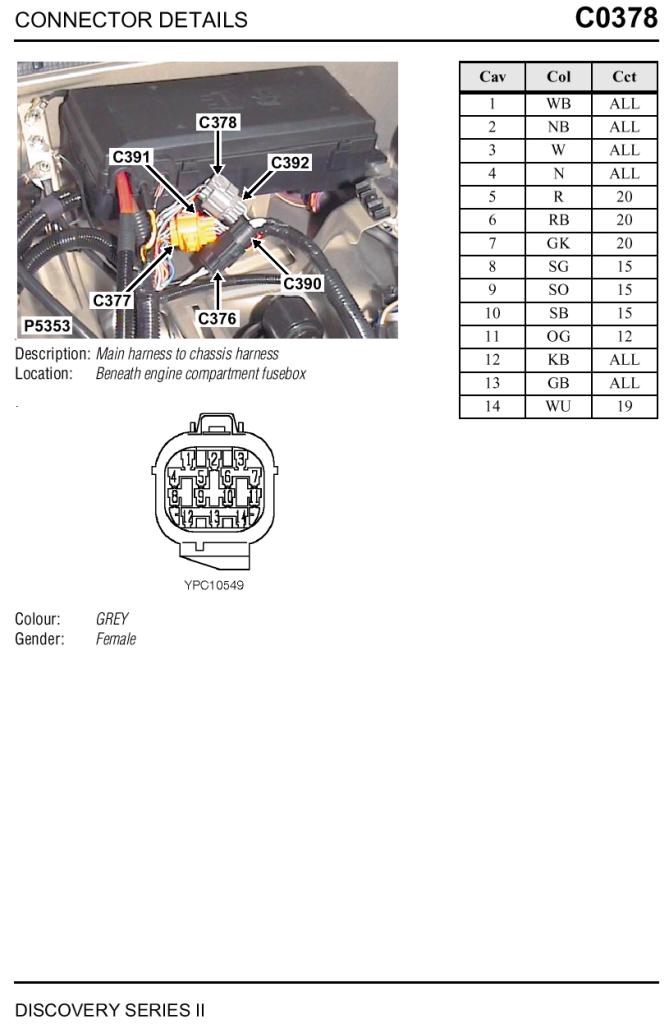

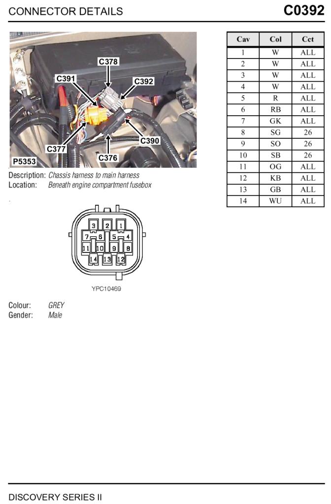

Here are the connector faces for the Grey 14 way connectors.
C0378 is the female connector on the vehicle's main harness -

C0392 is the male connector on the vehicle's chassis harness -

It's important that you connect the correct wires together.
To make sure that you have the correct wires, you will need to use a circuit tester to determine which wires come from which wheel sensor.
