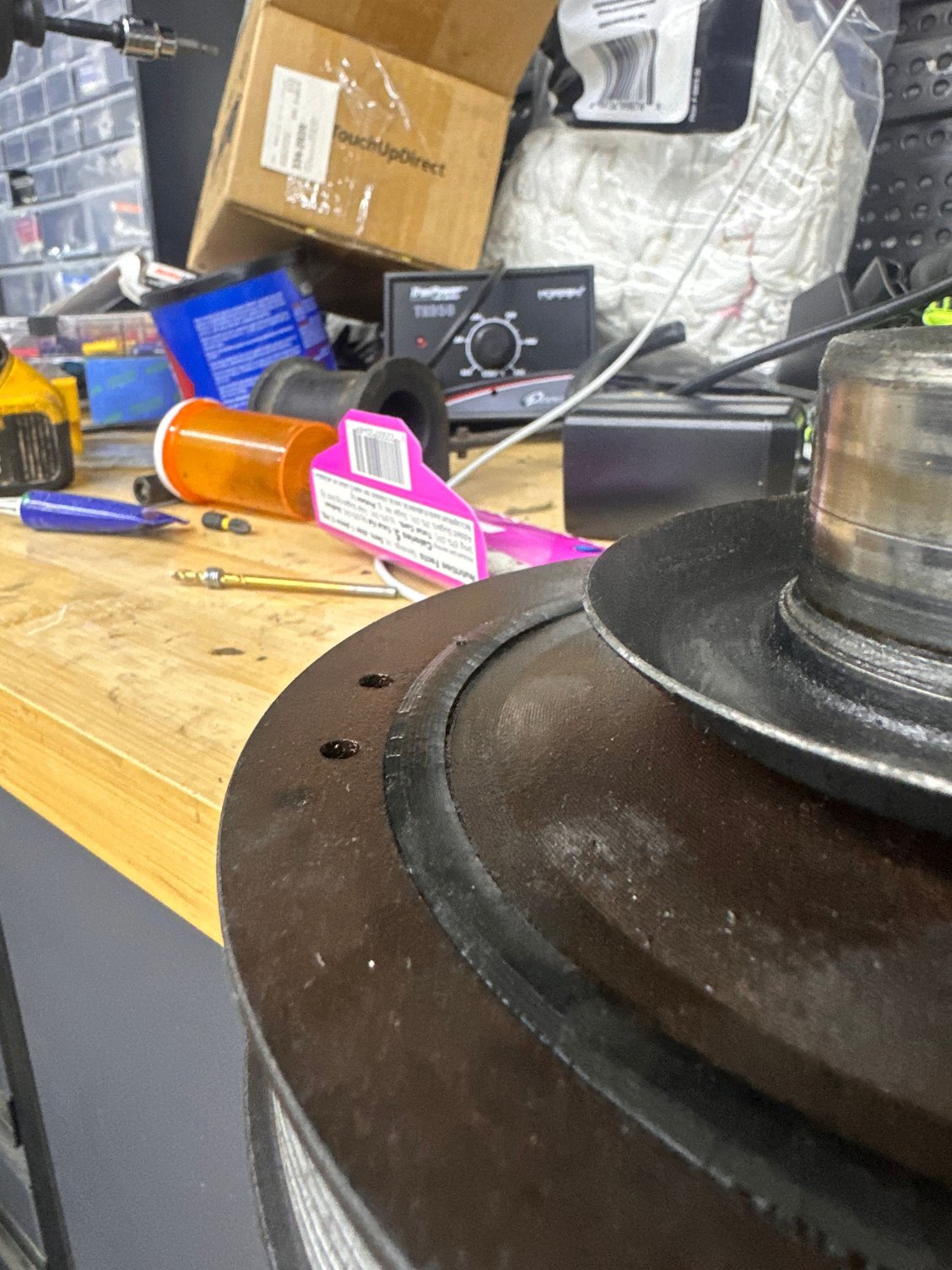

what does the balancer look like? all cracked and worn looking? that might be your culprit and the cost of a new one is quite steep if I remember correctly. One of my discos was like that and I found a better condition used one and that helped.

whowa004, attached are pictures of the balancer. It doesn't look too bad, though the rubber is cracking slightly.

Photo appears to show rubber pulled away a bit from the center piece, but hard to say from just a photo. There is a company on-line that will refurbish balancers by removing the rubber and replacing with new, for less price.

Also noticed a pretty good groove where the oil seal rides. Might need a speedi-sleeve to get that to seal again. Or a new balancer....
