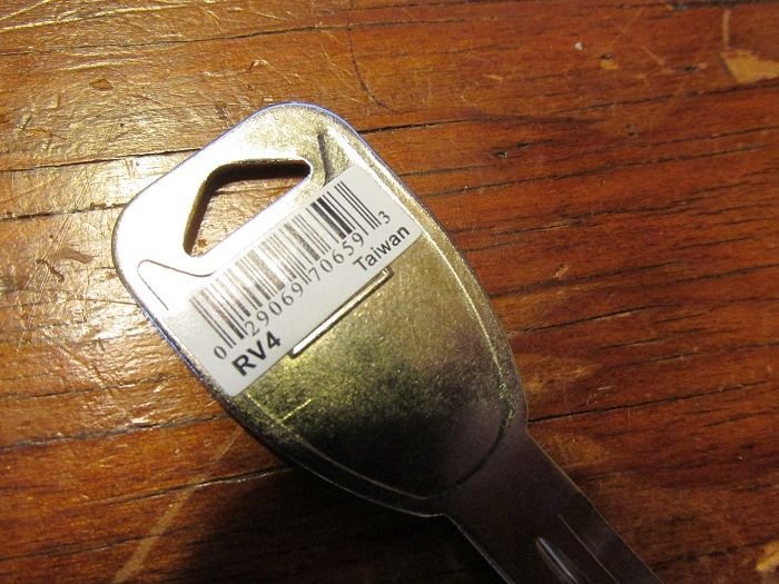

Ahab: just use an Ace hardware blank (or same) see pic. Fits perfectly. just have to mill and drill for the plastic key anchor or just have it on your key chain. The nanocom does not read the key. It reads what the BCU sees. In effect, you can see if your fob transmits when the key is 'detected' by nanocom through the BCU. But you have to program the 6 dig alphanumeric code on the board chip sticker. Nanocom reads the the 2-4 key code slots on the BCU. reprogram a slot that you DO NOT have a key for. If the fob is not detected, it could be the frequency (433 vs 413), battery, fob receiver, bad fob, not coded correctly...etc.....
sometimes, after programming the key, I have to write the gauge cluster to the BCU to get everything working again. The nanocom steps are not exactly intuitive, but it does work in 5 or 6 steps. For example, to delete an old key code, you have to move the cursor the the last digit, erase it, and then add the new key code. Safety feature i guess....
this is the Ace hardware key blank:

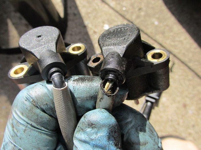

about $3500.... Just replaced the crank sensor with :
https://www.amazon.com/Walker-Products-235-1347-engineered-components/dp/B06XH1D255/ref=sr_1_2?dchild=1&keywords=walker+crank+position+sensor+discovery+2&qid=1592491344&sr=8-2 https://www.amazon.com/Walker-Products-235-1347-engineered-components/dp/B06XH1D255/ref=sr_1_2?dchild=1&keywords=walker+crank+position+sensor+discovery+2&qid=1592491344&sr=8-2

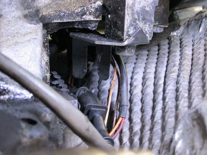

24$! You can see by the pics that the old wires were exposed. Surprised it even started. All the housing nuts/bolts were loose too. old one out and new one in about an hour. I did not drop the exhaust downpipes. Just enough room to get 7 and 8mm 1/4 sockets and wrenches in there.....BUT, the real PITA is getting the connector back on the mount. I have not been able to do this yet. I ran it for a while and got it nice and warm. No issues starting up!
Pry the connector off the mount with a short lever. The connector came apart easily. Press tab on harness part of connector.
heat shield. dangling CPS wire .
New on left. Not good on right.
F'n hard to get this back into the mount. Looks easy but ..........
