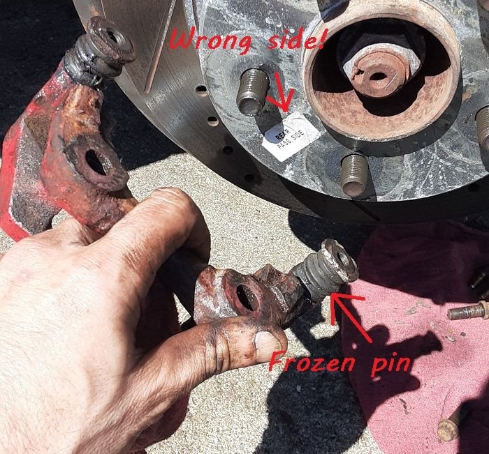

Had pull to left on braking. Took apart left rear caliper and found a rusted frozen pin. Now the shop was supposed to have replaced all the pins, but they only did 3!! the rusted one was a bear to loosen. Cleaned it up and greased. The pads were worn on an angle but new enough to still use. They will seat in a few trips to work. Also, shop installed the slotted rotors on the wrong side in the rear! Sheesh! Did not notice till now. Probably makes little difference, but I put them on correct side. Bled rear brakes. Now tracking under braking is way straighter! NICE!

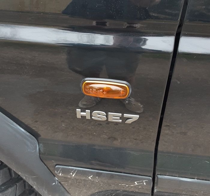

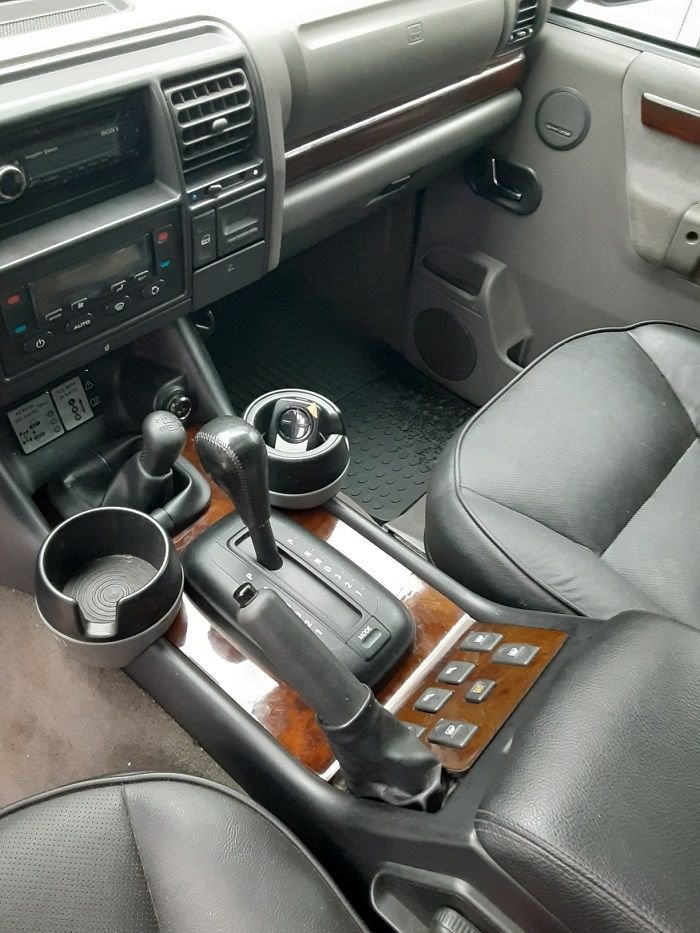

Installed a wood console. Now my interior really matches. Have to get correct length tab ring for the transfer case shifter boot. Can't find the part number(maybe for Disco I ?). Installed a new HSE7 label.
