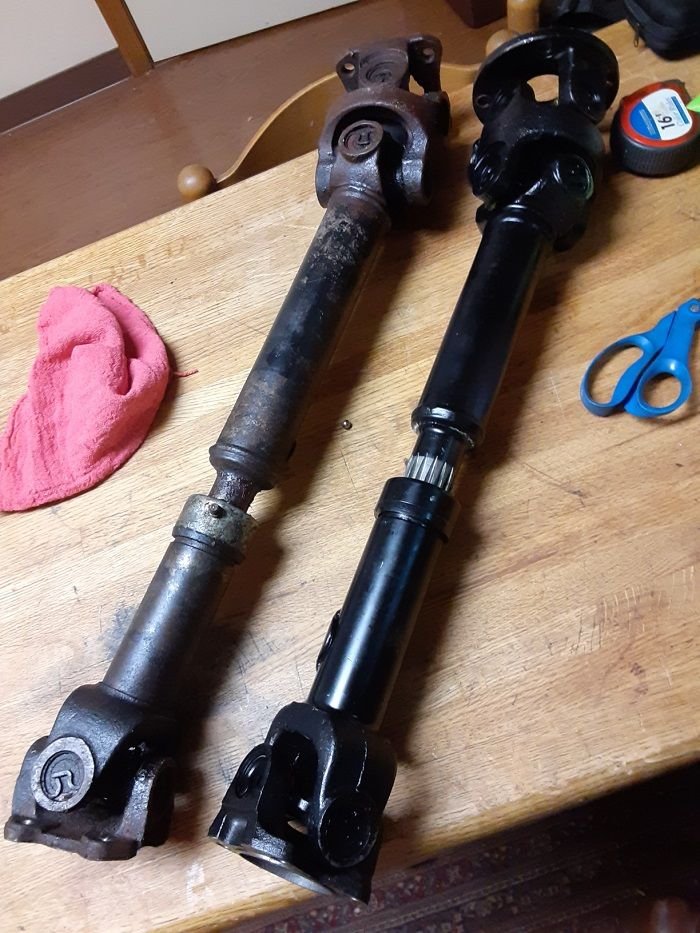

So the new TW d-shaft on right (weighs about 3lbs more) and my old TW one on left. Think I'm going to try a rebuild and keep it as a spare. The Proline shaft has been fine after 50 miles....

Im happy with the proline. I still have a tiny vibration when in 4th going up hill. It's barely there, but was not there with the old shaft. Might have to try the old hose clamp trick......

Tried some hose clamps , different weights, different positions. Still have a vibration in front shaft and a new leaky front seal (both issues were not there before), so I think maybe the output shaft bearing got damaged when my driveshaft went. Ordered a new one and another seal. Will try the slide hammer routine and see how that goes.....

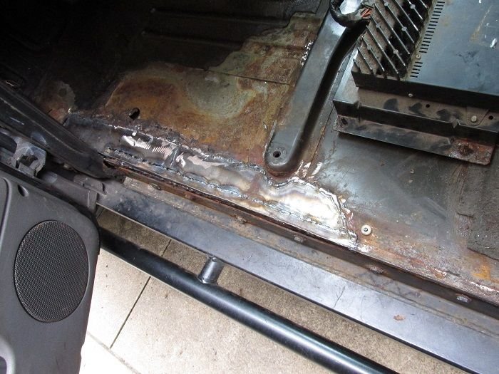

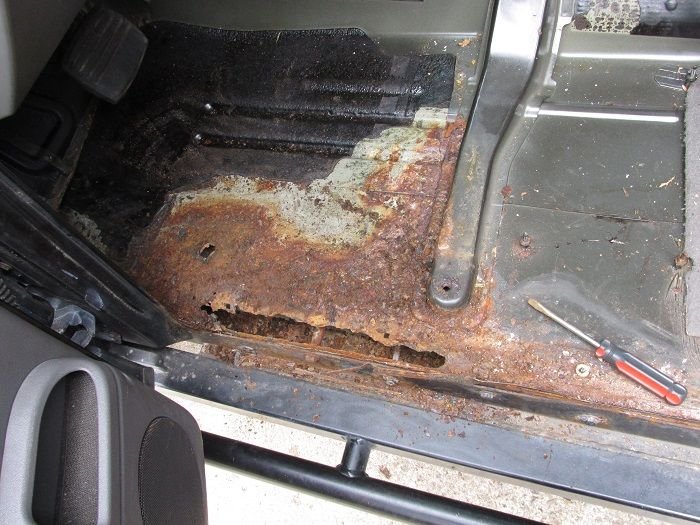

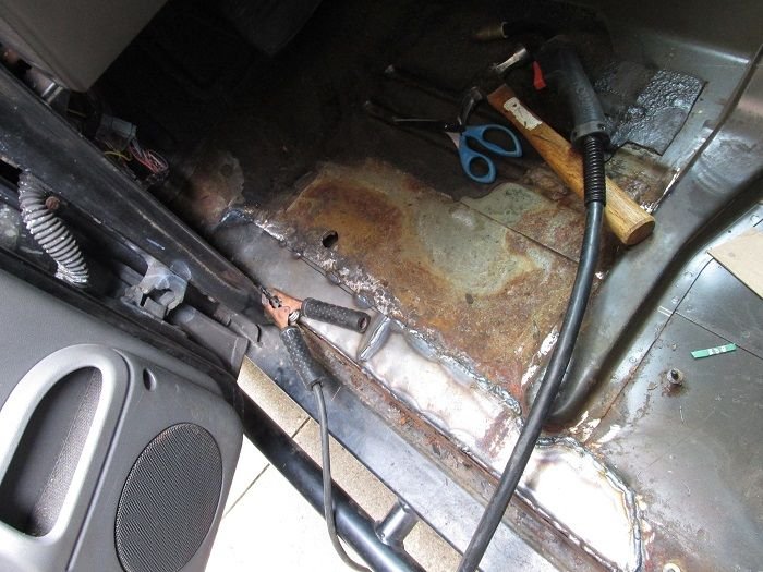

Did some welding today, too. Carpet soaked. Repaired two good sized rust holes, one at bottom of sun roof drain channel, and one at bottom of door hinge panel. The first pic looks worse than it was, that is staining of the soundproofing and light surface rust....Also repaired the floor and door seal mount. Should last a while. The AC drain is unclogged and does not show any cracks... Hope this fixes it. Probably have same issue on other side..... Also have two new front door seals to go in...
Plasma cutter and mig welder make this a 3 hour job.....
