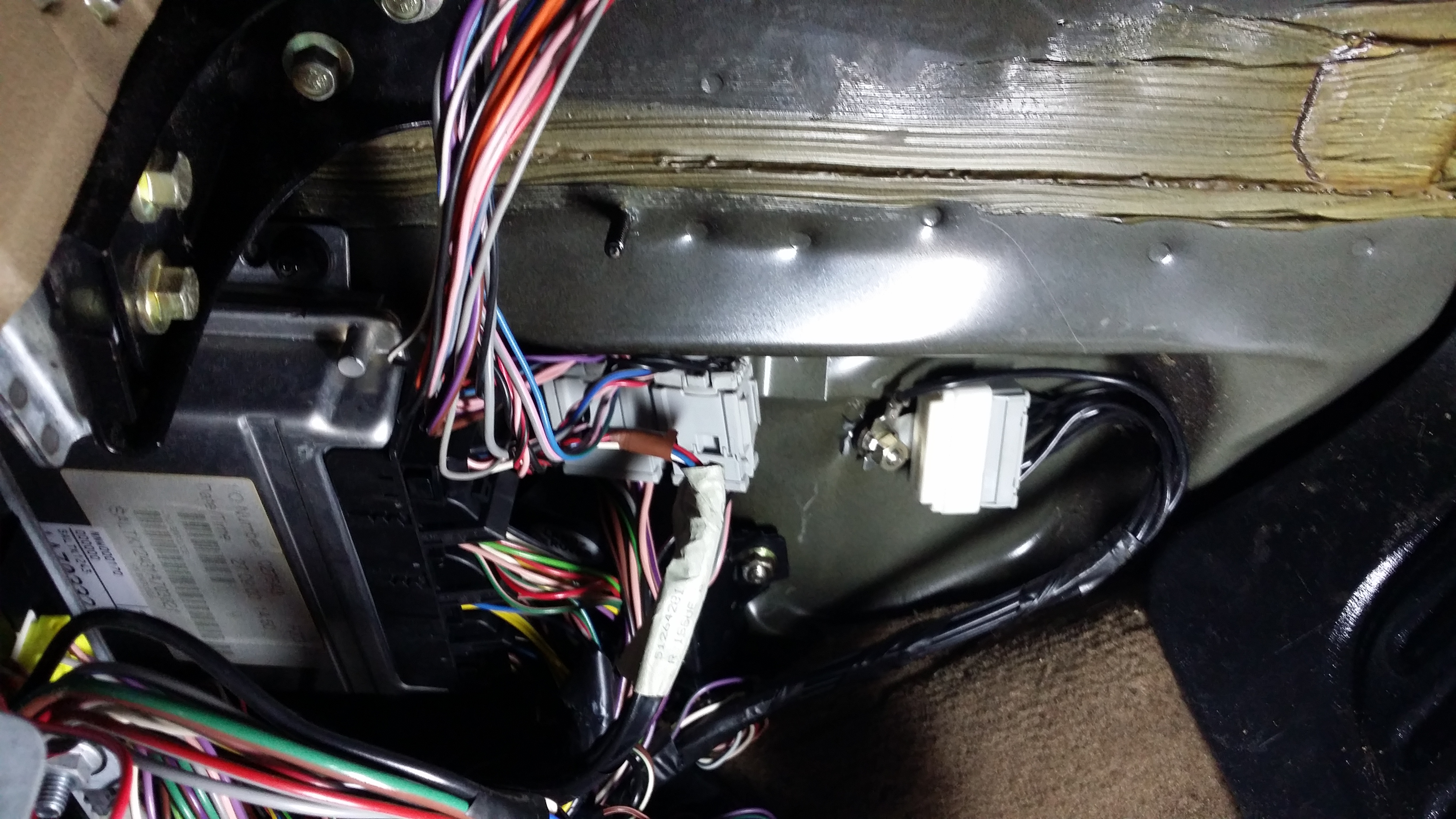

does any one know where is C0362 Ground mount is? I opened the passenger side under dash. I see one big ground at the bottom. But I dont see the single Ground in the manual.
Anyone know?

Found the C0362 Ground. I was looking at the right side. It's in the Driver side.
