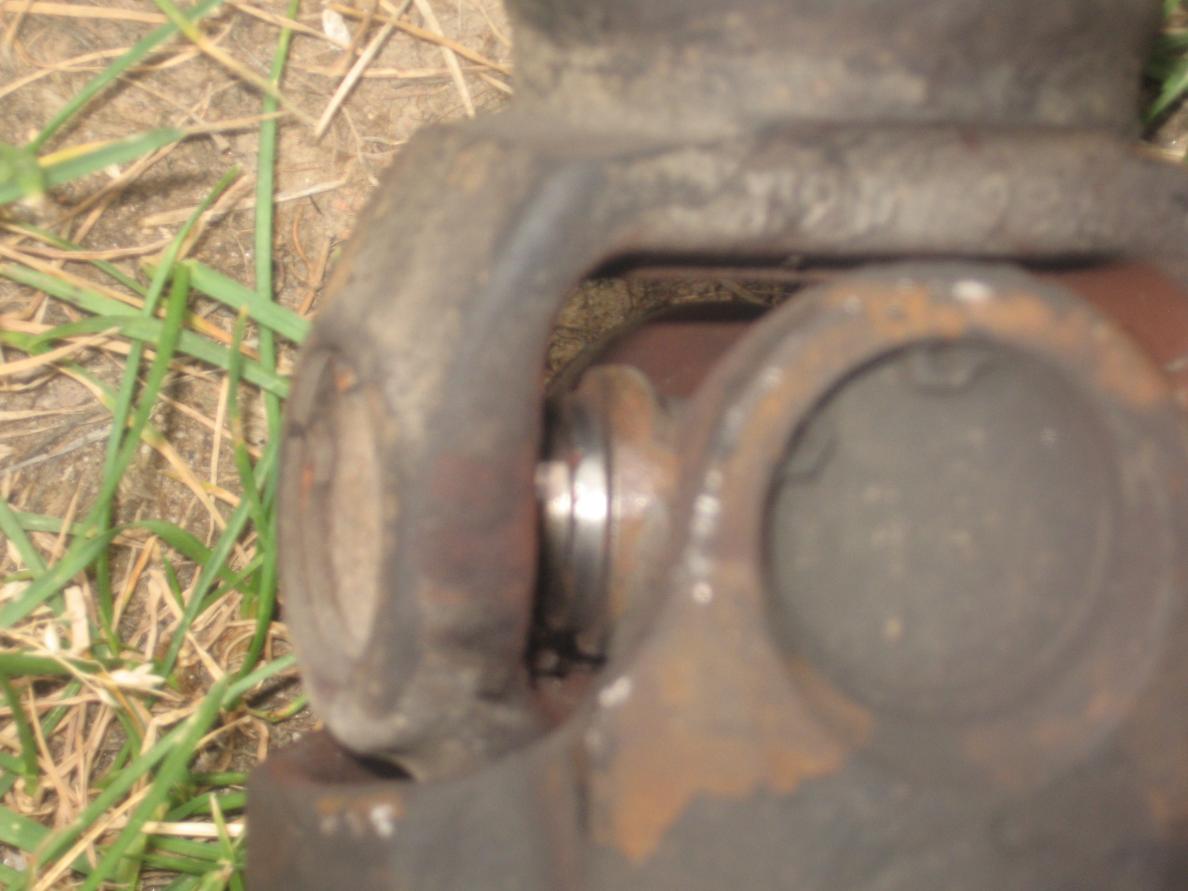

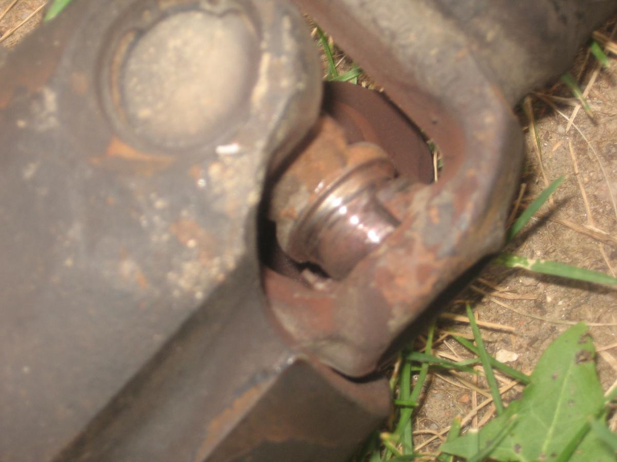

I just want to re-state something that Disco-mike, et al are always asking new disco owners.
CHECK YOUR FRONT DRIVE SHAFTS!!!!
Just to back this sentiment up, here are some pix.
This is mine, I got lucky. It didn't come totally apart while I was in motion, so all I have to do is replace a driveshaft. Had it come apart, it would have cost me a lot more $.\
On a side note, anyone know a good place to get a good deal on a new front drive-shaft?

I got mine from Tom Woods and rebuild my old one as a spare (you never know). From here it looks like you've only broken the grease caps - it looks repairable. take it to a driveline shop and have them do it + balance if you can't get a TW. They'll also be able to tell you if it is repairable, or cheaper still do it yourself with parts from napa, don't forget the centering ball kit. Don't know your situation, just layin out some optiions.

I think it's a total loss, but I might just take your advice and drop by a drive-line shop for a 2nd (more experienced) opinion.

i have a guy around the corner from me he ordered the 3 new Neapco u joints and the centering ball kit for like $90 and said the labor would be about $120.

If there's no damage to the yokes, then you can just rebuild it.
