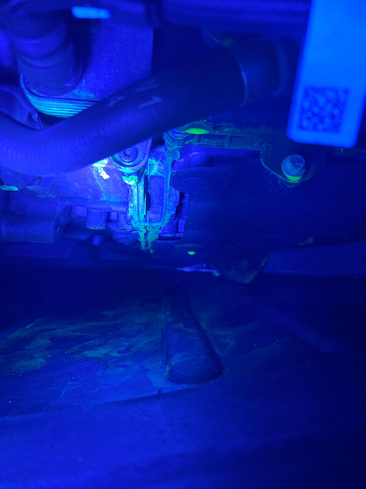

I am dealing with the same problem in the same location. I thought it was the quick connector on (what I'm guessing is) the water/oil heat exchanger (ham & cheese stack in the top left of your photo). I changed the coupler for an elbow and I still have the leak.

I tried out my cap today and it worked great. Found the leak immediately.
Here's a photo of the original quick connector I replaced:
This is the culprit:
The internet says it's a "Radiator Oil Coolant Liquid Separator" and it's absolutely covered in those stupid quick connectors. I will have to figure out how to replace them and then test the system again. it literally has a quick connector that connects directly to another quick connector *face palm*
