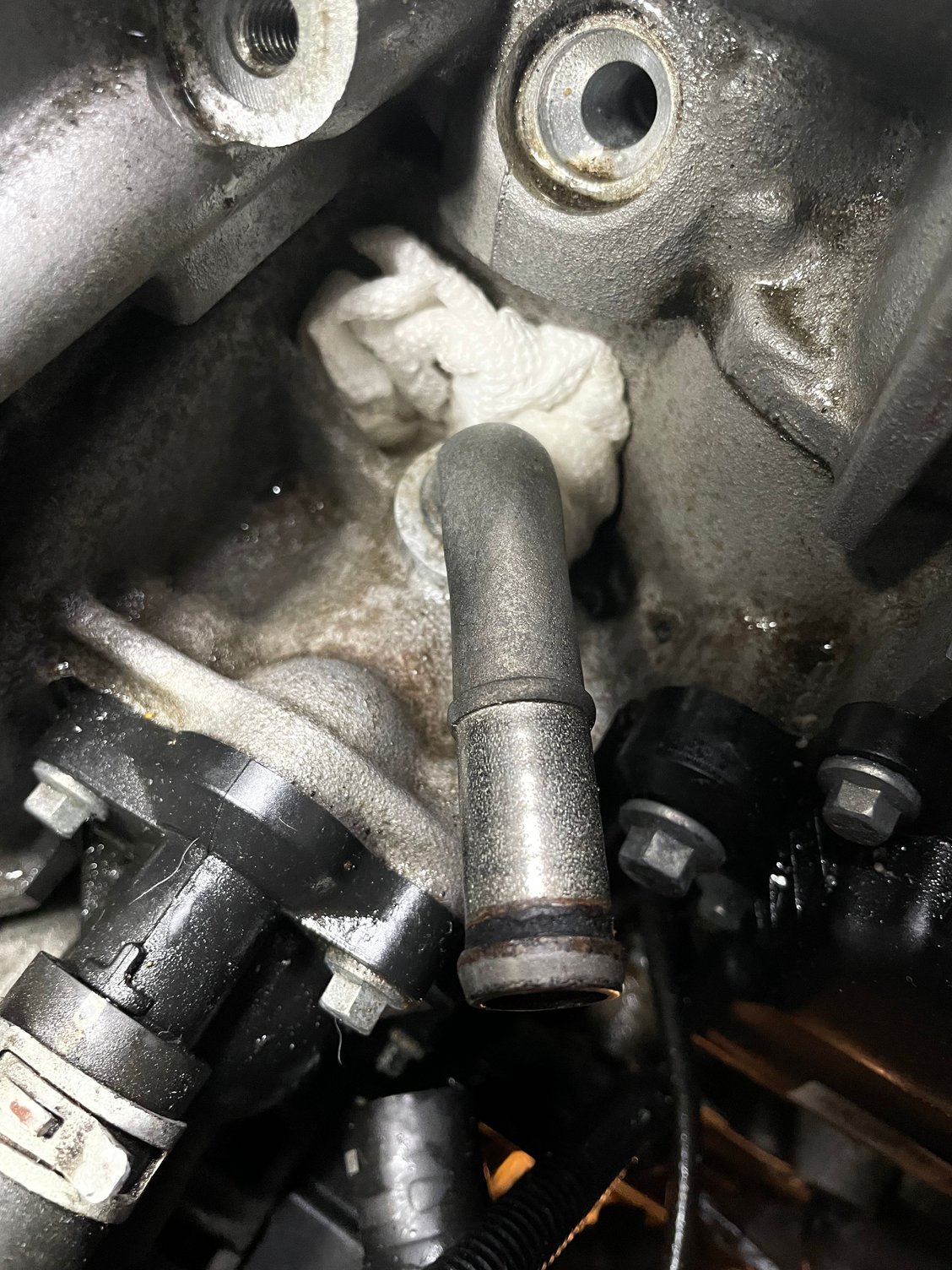

Hello everyone. First post, first time I've needed to tear the Land Rover down.
Small coolant leak for several months.
The pressure tester I bought did not fit, but I've isolated leak to a small area.
After pulling intake and fuel rail, I can visualize this junction plate (assuming there is a gasket under it?) that may be the issue, but I also can't eliminate the 90 elbow fitting as potential problem.
There was a build up of dried coolant at the base of the fitting and some coolant pooled in the block casting depression behind the fitting.
There is no crack on the neck and hose to fitting loosed fine, but is the base of the elbow a failure point? How is it attached to the block?
Advice?
Thank you ahead of time.
Dave

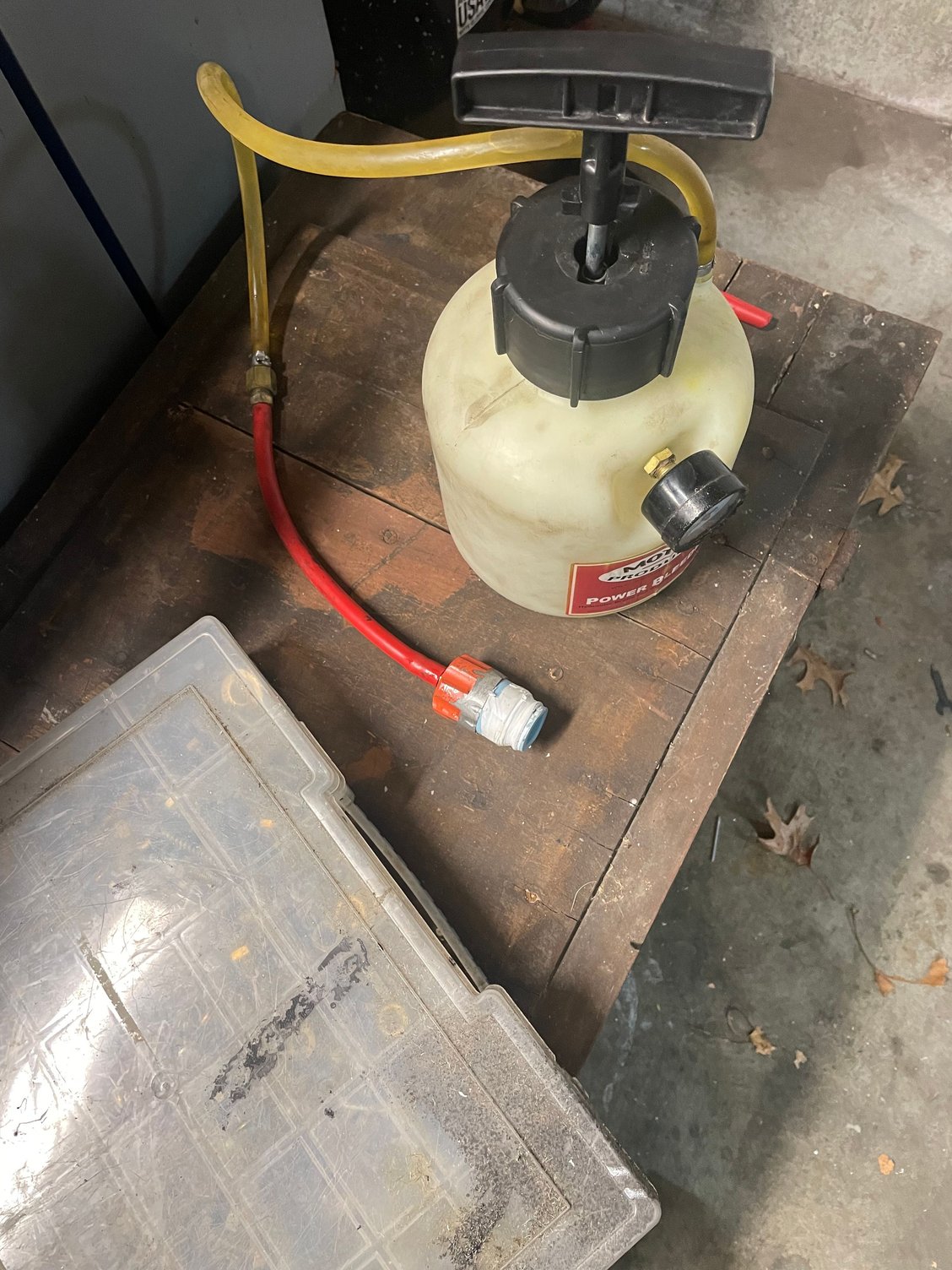

Fabricated a plug to pressurize the coolant system.
Determined leak was subtle but weeping at the side of that plastic plate.
When removed, obviously its the thermostat housing
Upon inspection, there's a flat spot on the gasket from over toque -- assume factory, I don't think this Discovery had any real deferred maintenance prior to my purchase this year.

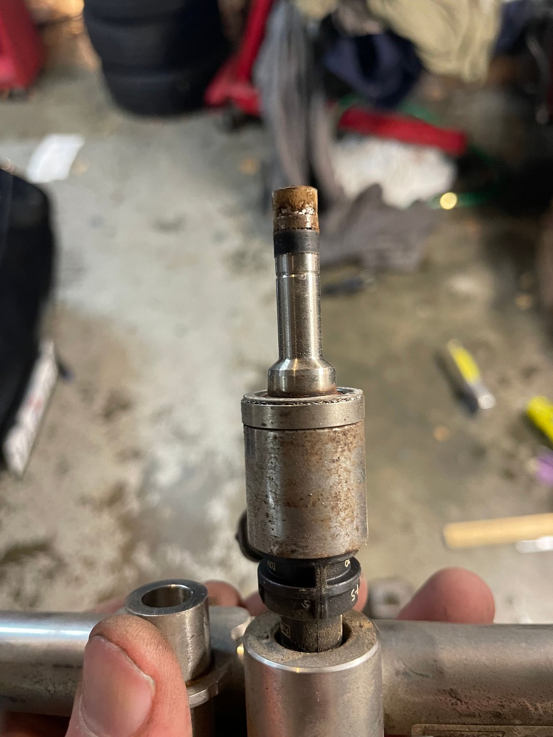

The injectors look horrid.

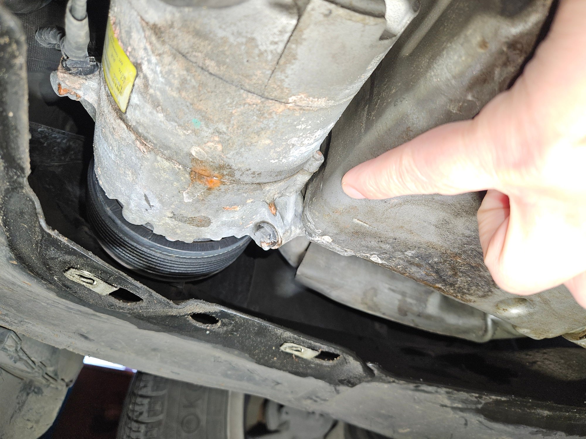

Been away a long time - my 2016 Discovery Sport, 120k miles is acting up. It looks like I'm having the same issue when comparing pics. Slow leak.
Thermostat housing, you say?
Coolant droplet on the right has a trail...it's coming from the area above the oil pan area.
No leak around water pump.

Update: Thermostat housing. Took it in to mechanic, they pressure tested it and confirmed it was the thermostat housing.
