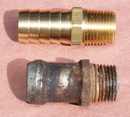

Originally Posted by TOM R
electric gauge or mechanical?
IMO mechanical is always better if you can route them.
More accurate (you know there's flaky electrics throwing off the the readings).
Originally Posted by drowssap
for gauges you will want electric, you would not want to bring hot oil or hot water into the passenger compartment, especially up on the dash. jmho
I take it you've never used mechanical gauges.
For oil pressure gauges they don't flood the drivers compartment with oil if the line blows or something like that, at most it seeps out, which I've never seen in over 40 years of using them. Provided the installer doesn't do sloppy work.
Temp gauges use a thermocouple and don't have any fluid going anywhere.
Tom, here's another simple/easy/cheap/very worthwhile mod.
Details here https://landroverforums.com/forum/ge...anifold-51656/
