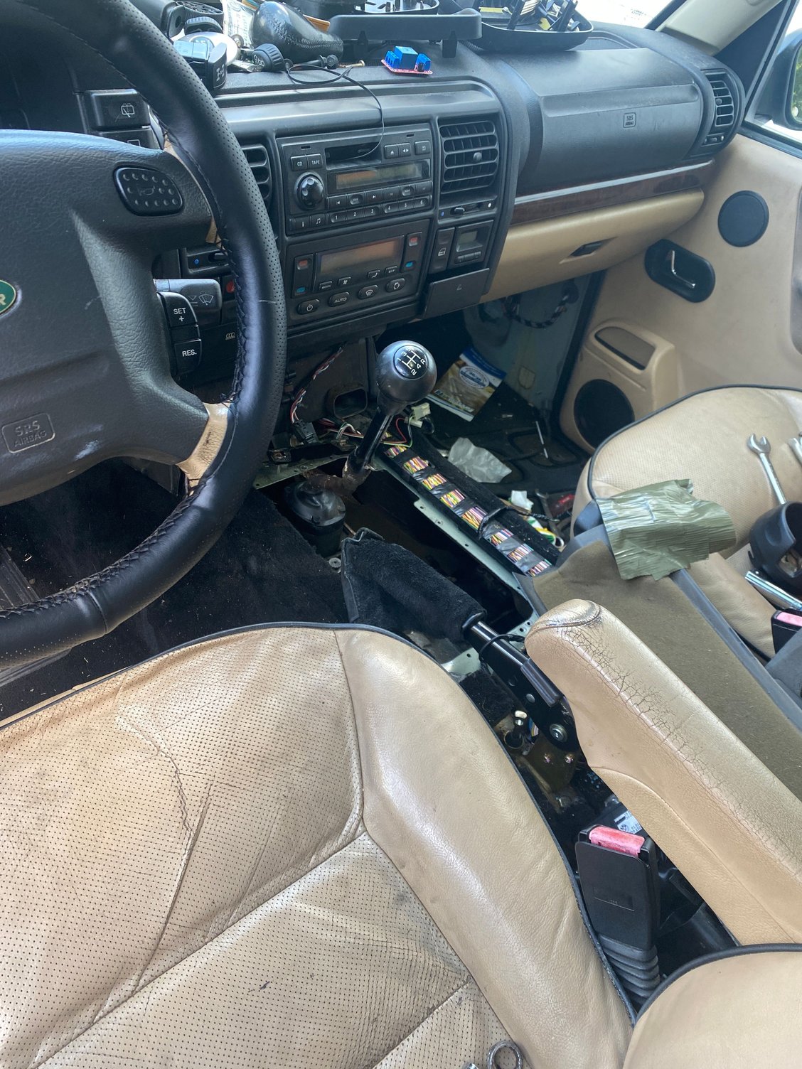

Default Engine is in! -not yet running
I had hoped to be finished at this point, but we are at least pretty close. Here are some pictures of where it stands.
Engine in place
Shifter location (in third gear) - will fab up new plate for tunnel cover and move high-low shifter. Will post pictures when complete.
Hope to have it running by the end of September. FYI I need to re-name the thread… definitely not as much of a budget build as I had hoped. Granted, most of the cost was in rebuilding the engine and transmission. The actual parts required aren’t that crazy expensive. If I had it to do over, I would definitely consider more heavily the ACE kit. There is something to not having to fix a ton of problems of your own making. Just hopeful that it will ready the truck for another 150k miles.
