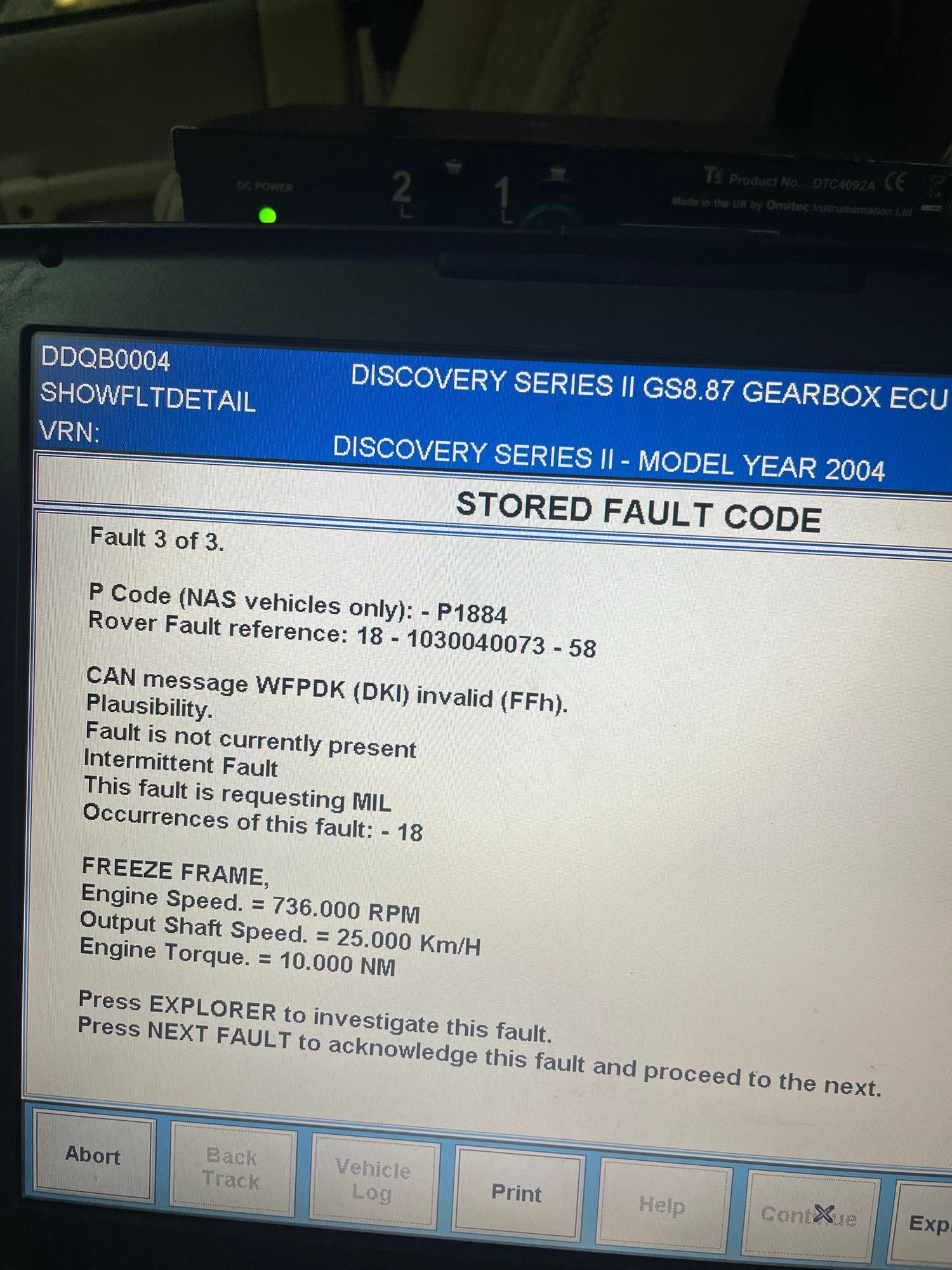

Thank you both for these posts. Wondering if that is my issue as well. My symptoms a little different in that the Hill decent, traction control and M&S lights come on consistently only when I turn on the AC/HVAC. If I leave the HVAC off, no warning lights come on. With warning lights illuminated, turn HVAC off and restart the engine. Lights will go off. Engine functions perfectly no issues starting running etc. RPM showing normal.
This did work previously (no warning lights). After fan shroud install adjustment to some of the wiring this issue started occurring.
- Replaced the CPK just to make sure that wasn’t issue
- Disconnected plugs for the electric fans (radiator). Issue still occurs.
- Increased idle to 800 then 850. No change (thought maybe it was dip in idle speed)
Appreciate any help.

The T_ANS and MD_IND are from not running the MAF. On their own, I do not believe they will cause the M/S lights.
WFPDK is TPS system and related circuit. Since your problem is only when the A/C, my guess is the A/C is causing a voltage/current drain. New ground like Boostle says may help. I’d also check the ground from the battery to the engine block - if it is not a solid point it can cause a bunch of issues. Have also heard of adding additional ground from block to body.
