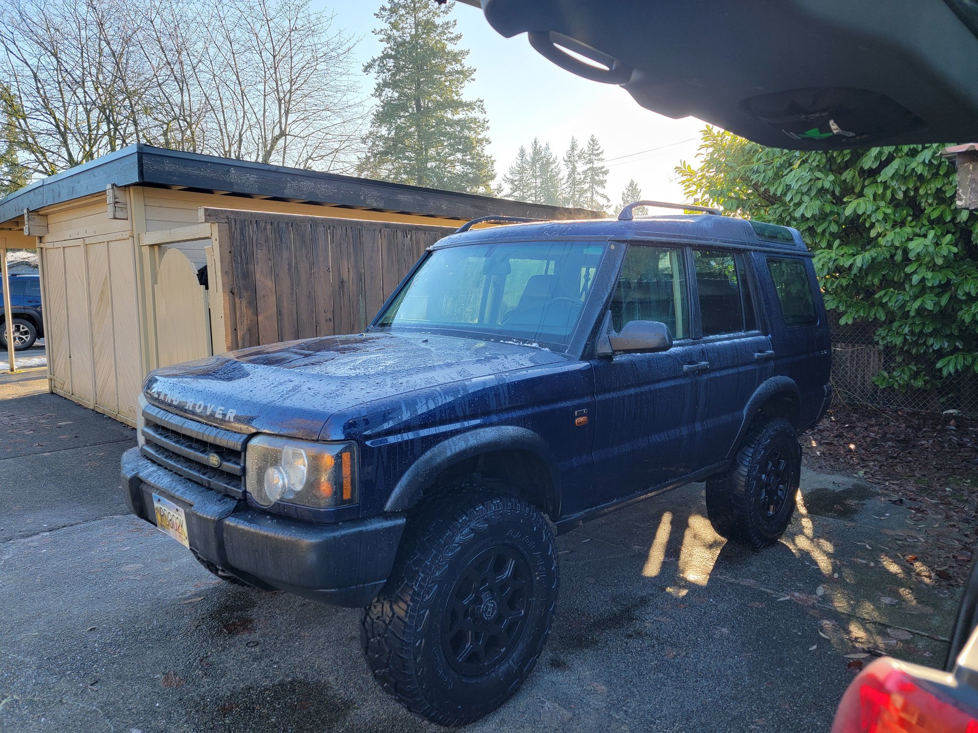

I am pleased to report my swap has been fully completed now.
Everything working in normal order, no lights on my dash, no problems at all.
This forum is invaluable to anybody wanting to attempt this project. Everybody on this forum was incredibly helpful throughout, and I probably would not have attempted this myself without being able to ask questions here or find information already posted.
Big thanks to everyone on here!
I am posting progressive updates on Instagram showing the different aspects of the swap, and hope to fill it up with a whole bunch of off-roading adventures soon. Give me a follow @604x4BC !!
I hope to see you guys out there one day!
