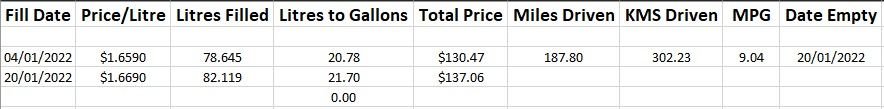

Originally Posted by 604x4BC
Tracking my MPGs for the first time ever in a vehicle over here.. How's this looking so far compared to the rest?
(I know I have to do this a few times and take an average..)
I'm in Canada, hence the KM & Litre conversion info...
MPG seems a bit low. Mine usually ranges in the 12-15 area. Might take some more miles though as things get settled.

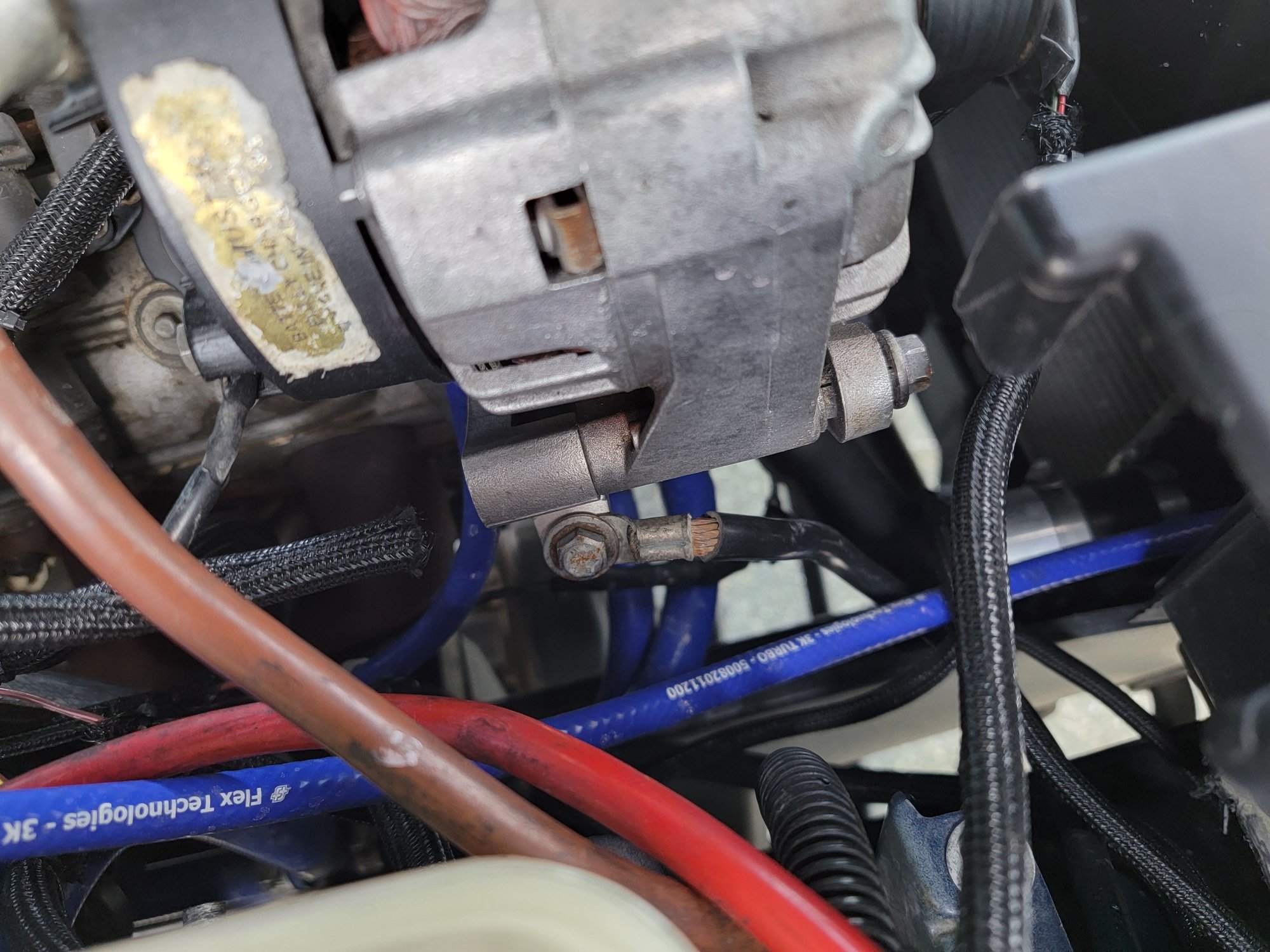

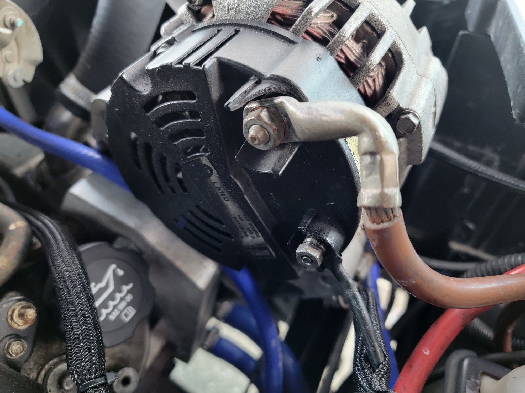

I've been getting a repeat engine code pop up, anybody else had this one?
P0507 - idle Control System RPM - Higher than Expected
need to do some more looking around of what's happening....everything is working just fine...I noticed this morning it came back while I was coasting, no gas...RPM was somewhere between 5-1K...
Reading online a lot of talk about cables running from the alternator..;
- I've got a positive lead connected to the back end, negative lead connected to the bottom bolt hole, and then a lead going from the back into the ECM.
Does it look like I've got my cables in the right spots?
I've also read things about MAF and intake...I know some have had to cut the baffling from the intake box for better airflow...could this be something?
