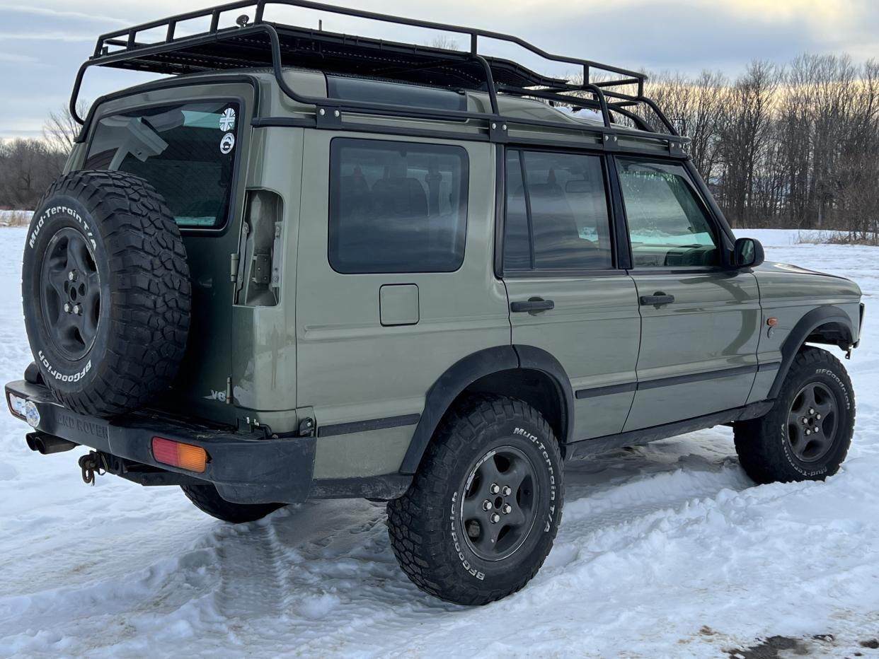

I've always wanted a land rover, and recently picked up a 2001 for my son for his first car. It is in great shape, but we're doing all of the typical disco preventative maintenance - hoping to teach him about mechanical work in the process.
Somehow I got swept up in it and bought a second "parts" vehicle (another 2001), but this one with a blown engine. Now that I have it home, I'm considering putting an engine in it and making it a trail rig (saving my 200 series land cruiser from the harder trails). I haven't heard it run (radiator taken out) but I'm told it is bad. Not just a bad head gasket, but full on sliped sleeved destruction. I'll probably pull it apart for fun when the weather gets nice, but 99% chance needs to be repowered. If I do keep it, it will be gutted except the front seats and I'd build cargo boxes for the back to hold recovery gear, tools and spares.
I've spent hours and hours looking into LS swaps, primarily with the ACE kit. I have a line on a decent L33 that would do the trick. I've read the gigantic ACE thread, browsed this forum, watched the whole Youtube series from Lost Cause Ranch.
I've done a lot of mechanical work including several swaps of engines into vehicles where they never belonged. I've rebuilt engines and transmissions. I have a well equipped DIY shop with a lift and pretty much any tools I'd need (but never enough tools ). I mig, tig and gas weld, but my welding skills are *super* rusty (I'm probably not going to weld my own exhaust), I don't do my own alignments, or set up diffs. I'm not afraid to tackle most anything else.
