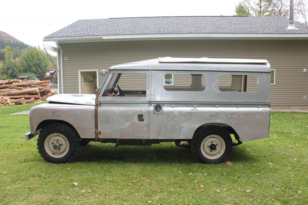

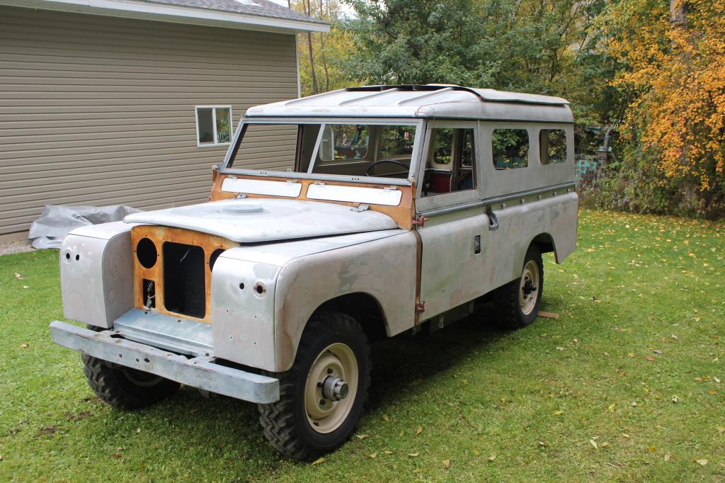

Bringing it home!
[IMG][/IMG]

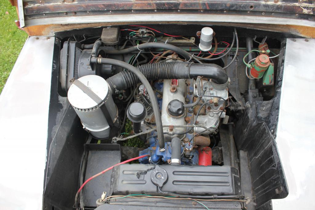

Finally got the engine to fire tonight which is a huge relief! First of all, we quickly discovered that there was no spark at all. We were unaware that the distributor had been taken apart and after CAREFUL inspection we found that a very small and thin plastic washer was missing causing a short. After replacing that, we discovered that the spark plug wires were in reverse firing order. After fixing that (and a dump of gas in the carb) the engine fired!
I am hoping that this is all I will have to do to the engine for now other than cosmetics like painting and replacing hoses etc. with plans to rebuild the engine later on.
The only thing I am considering/concerned about right now is hardened valves and seats. I've heard that some people dont bother with it running unleaded gas and they dont have problems. Does anyone have any thoughts or experience with that?

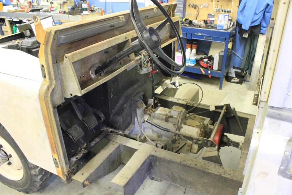

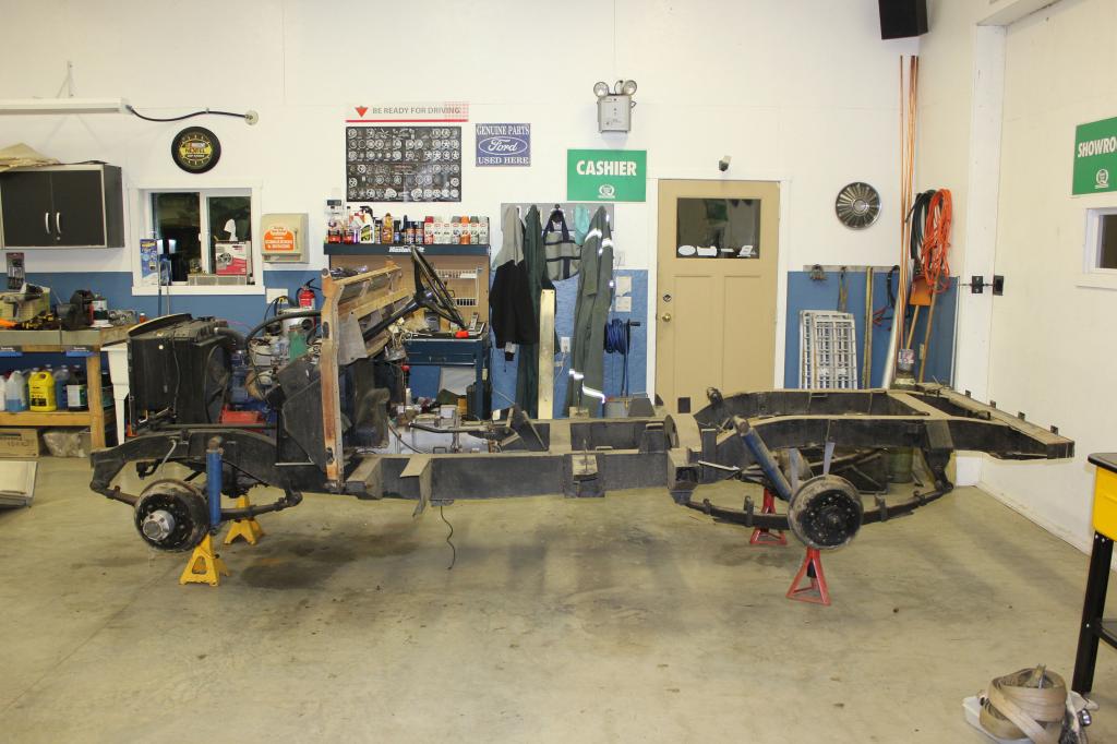

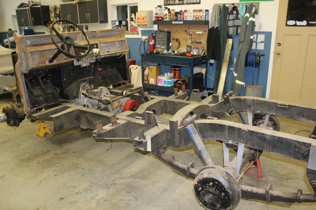

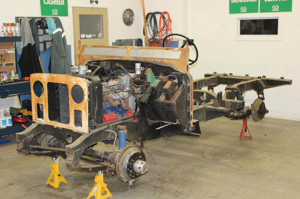

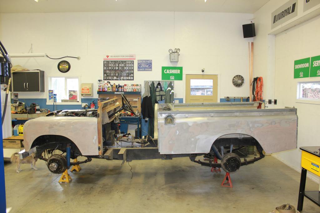

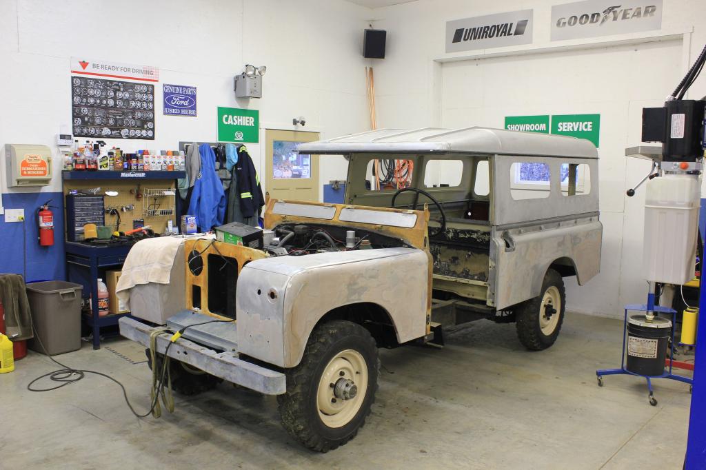

Here are some pictures of the tear down so far. From bringing it home Oct. 10/2013 to today (Nov. 20/2013)
[IMG][/IMG]

Old Nov 21, 2013 | 12:23 PM
Koopsy's Avatar
6th Gear
Joined: Nov 2013
Posts: 6
Ya it had been painted about 30 years ago along with the shocks replaced and springs recurved. But it had been sitting outside in the weather for quite a while so I have found a few holes and one outrigger that needs to be replaced but other than that its a lot better than it could have been!
