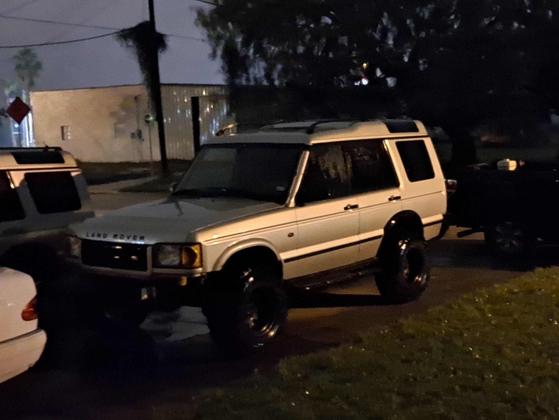

Began in january of this year with the swap and now shes running 😁 im just waiting for compushift to have transmission controllers back in stock to resolve the shifting issue. Heres a link to my youtube and a pic of the ol girl. video. https://youtu.be/ARFg075icYM

I take it out to the local gas station close by and i love when people turn to see it with a confused look in their faces hearing the diesel chatter and turbo spooling 🤭🤭
