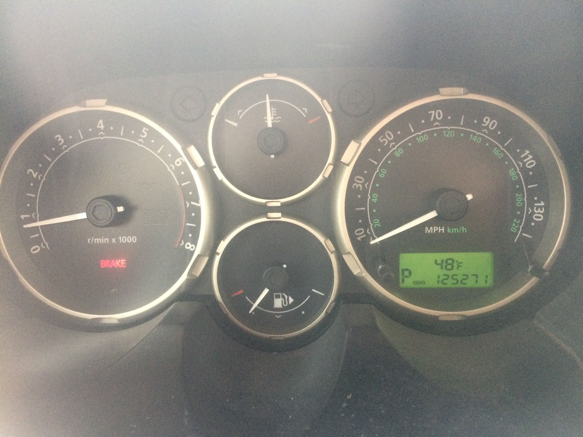

So I went out and looked at mine and here are some issues I see based on turning my car on and observing-
Your "check engine soon" light should be on when the key is on but the engine is off.
Your "check engine" light is also not coming on when you turn the key on (it should be on the opposite side of the tachometer from the "check engine soon" light and should turn off when the ABS and SRS lights turn off. It is possible that somebody pulled the bulbs to hide an issue, so I would get a scan tool and check codes ASAP. I use a cheap bluetooth one from Amazon with a tablet and Torque Plus on my Freelander.
Your temperature gauge is maxed out, hence the red led. That probably means the sensor is bad.
Your traction control and hill decent lights are both on, that often means the brake pedal switch has gone bad. Those should turn off after a few seconds.
Your odometer display is not showing what gear you are in, so I would definitely check the gear shift position switch. If the car doesn't know what gear it is in, it won't turn over.
Key on, engine off. The battery, check engine soon, and oil pressure lights are the only ones that should be on here (and the hand brake light if it is pulled up). Note the park indicator on the left side of the odometer display.
Engine running, all lights off.
