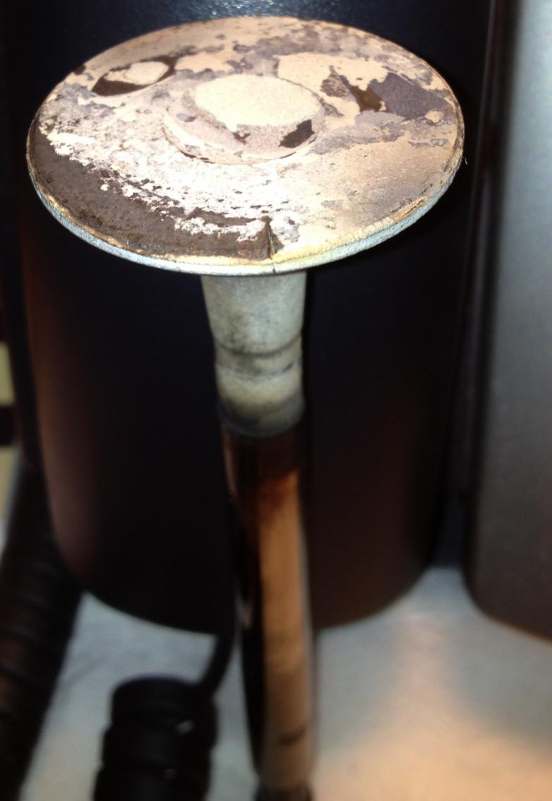

Echo that. I think the 4.6 and 4.0 are the two smoothest V-8s ever made. I picked up my 03 deer killer disco with a misfire code for cheap. Turned out to be a burned valve using crap gas.
I port matched the heads and cleaned up below the valves a bit when I put it back together. Good power and silky smooth. Best in the RR with the chain drive transfer case and the wonderful gear whine. I suppose my rant suggests I like my Rovers.
