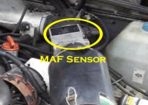

can you tell me where the maf is? i will unplug it after class and see if that helps...

Make sure the engine is OFF when you do this! Its right after the air filter

Thank you! When I got home I realized I had one of those CD manuals and will reference that in the future. I drove it to the parts store to get some cleaning spray. I disconnected and reconnected the MAF sensor in my garage. When I backed it out of the garage the car was running really rough in partk. It died 2x once at a stop sign just down the street from my house and then about a block later. It just died will driving. . . I started it back up again and IT RAN JUST FINE. I was able to make it to the parts store and back with no problem.
I unplugged it and plugged it back in. I got some MAF cleaner spray and unscrewed the MAF disconnected the houses and sprayed it out. I also cleaned out the connectors with an eletrical cleaner (I noticed some build up on them).

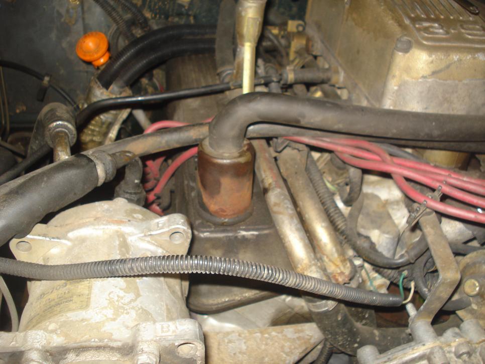

Also, is this the breather filter? In this picture? It looks a little worn down and I was going to replace it. Could this possibly be the culprit?

Okay. . . It's been a few days and I drove my vehicle about 100 or 200 miles. . . The problem has not come back. I changed the fuses, and cleaned out the MAF and the sensor. I also noticed that my crankcase breather filter was heavly gunked up with sludge and I cleaned that out too (I'm going to order a new breather filter). . .
I saw build up of sludge under the valve cover (if that's what my crankcase breather screws into). . . I'm wondering if I should get that cleaned out?
Regardless, the problem has not resurrected. . . since I cleaned out the crankcase breather and MAF.

If it happens again, check the codes from the ECU. Its a display under the front pax seat near the door. Might have to remove the plastic trim to see it. I took it off its mount so i could see it from the front access of the seat. It will make since when you find it.
It should throw a code or two if that sort of problem resurfaces. The codes are in the Rave manual, or just ask here. The rave has a series of test to do on the ECU so you can find the part that is causing the problem. Much easier than throwing parts at it.
I would check the idle air valve if you had that much gunk in the top of the engine. here's the link
http://www.okierover.com/airidlervalve.htm
