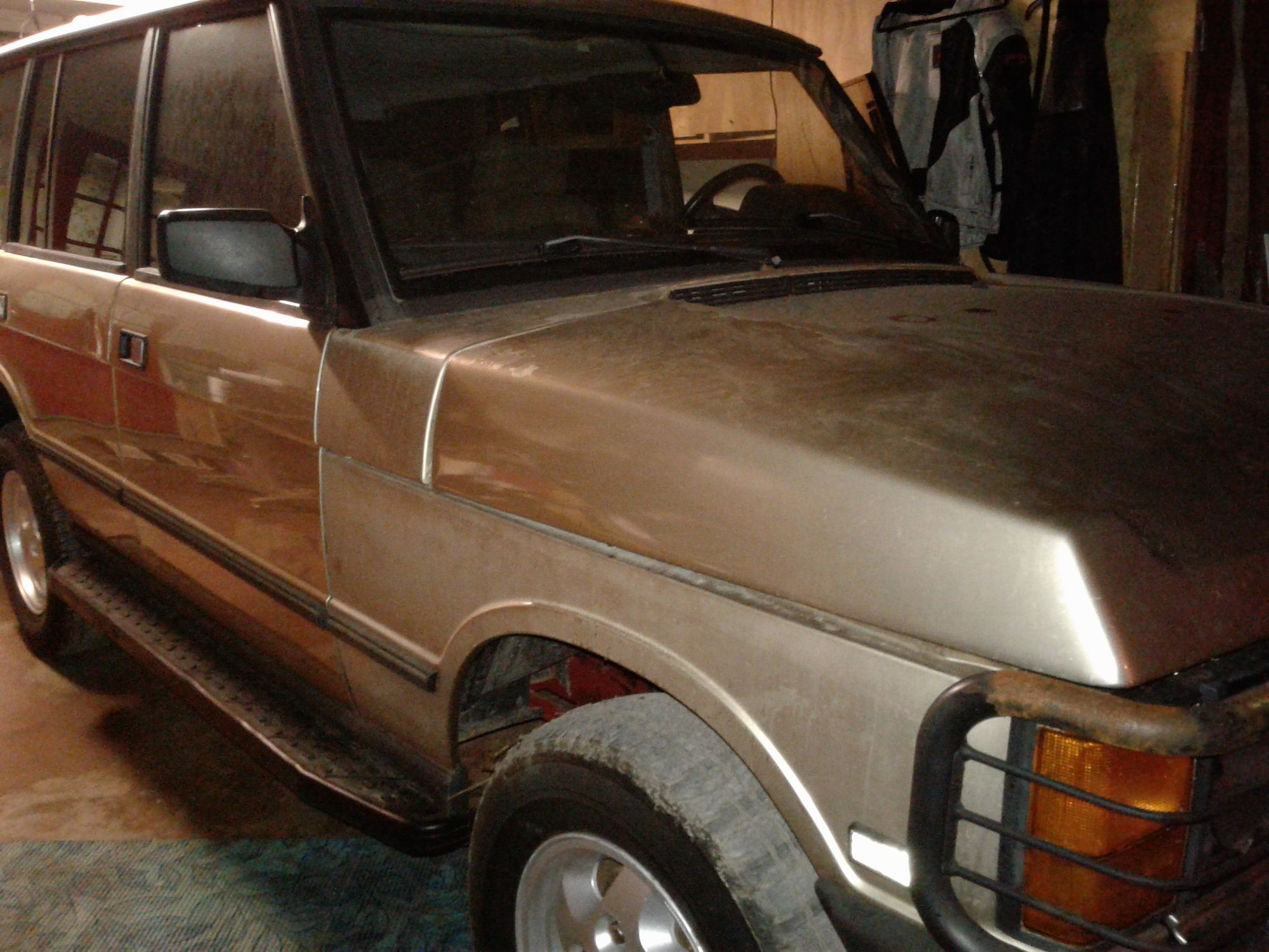

Picked up a '95 on Craigslist with no keys. Pulled the ignition switch and powered everything up but, would not turn over. Alarm didn't go off so I am assuming that it's not the immobilizer and could be just a bad starter (haven't checked it yet). My question is this...if I hot wire the coil, fuel pump and push button the starter, is there anything in between to keep it from starting. I've had two D2's and a '96 D1 but never one with a distributor and never a Range rover (lots of things under the hood I don't recognize). Just want $400.00 poorer now
to see if it runs and shifts before investing time into it. Any help is appreciated!
