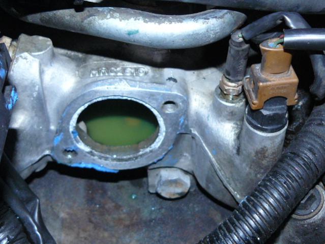

A temporary water temp gauge could be installed just under the hood for testing. Here is a pix of the intake area with stat removed. The coolant to ECU sensor is on the right, gauge sensor has the single wire. That "bolt" at the bottom is a plug for what used to be the hot water to heater core in older designs, and might be present on yours. A potential spot to plumb in a gauge sender. Of course, you might be using your old sensor with the old gauge, and in theory it should be working. In which case the temp range is scary.
This swap brings up another issue, the heater core. The GEMS setup had coolant always flowing thru the heater core. Older Rovers have a valve that switches off that coolant.
I'm not worried about the air flow at highway speed. But at idle you'll want to make sure the electric fans are keeping up. Mechanical to electric converions posted about on here have not produced the desired results usually.
