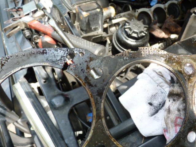

My HG had an exhaust leak sound popping (like a lawn mower) that came on suddenly. You can see where it burned a path to the outside. Locate by using a length of rubber hose, listening thru it as you move other end along the gasket edge.
