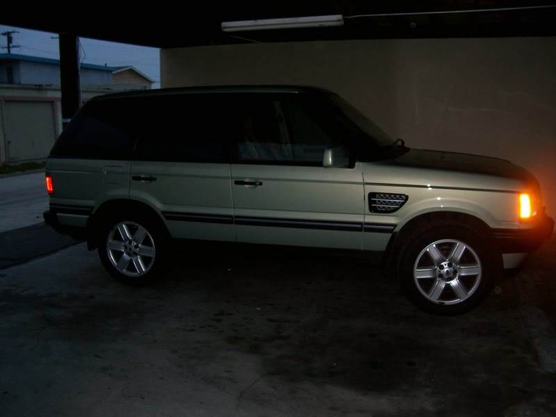

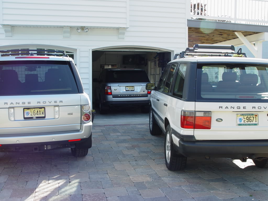

Note photos below - if the wheels are as on my P38, yes it will work but these are off of my 05 (which is now gone). I don't understand the wheels saying LR 2002 - that's either a set off of another model or something - because the nuts should match up. However, you did need hubcentrics (to fill the space between the wheel center and the hub) and the new lug nuts (to account for the difference in depth). My rings
came from overfinch -

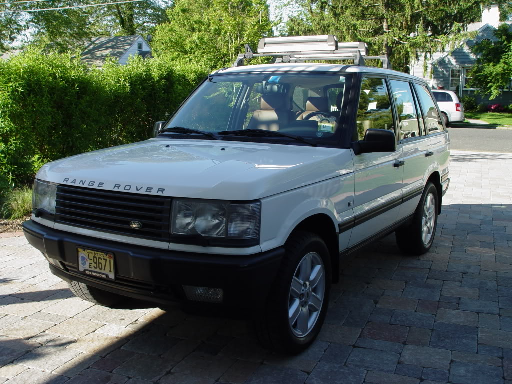

It didn't make sense to me either but when the lugs didn't center in the holes of the rims I knew I was in trouble. I thought the rings will help if the lugs at least line up dead center in the holes of the rims....but that's not the case. This is a picture of the existing truck with factory rims and these are the rims I'm trying to put on.....any other suggestions will be helpful.

What is that, a 4.0 P38? What size wheels are those, are they 18's and you're looking to put on the 19's?
As you can see from my photo(s), it's entirely possible but you have to have a bolt pattern that matches up....the lugs themselves
(the one's you have) won't work - it will require the new one's to allow for the difference in depth of the wheels.
