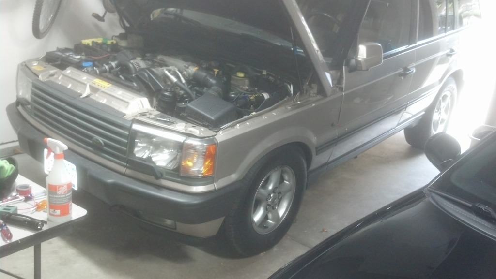

ok i have a big problem and i'm just completely stumped.
i've rebuilt my valve block, replaced my pressure switch and now my rover is just all over the place. i took my time to follow the valve block rebuild instructions step-by-step and i'm not finding any air leaks on the block after the rebuild with the soapy water test.
its only inflating the rear bags, and even those aren't being raised evenly. the rear right pumps to full off road mode and the fronts are completely dead and it will not level itself.
the height switch on the dash is entirely useless, and sometimes its even inflating the bags WITH the door open. idk what the hell is wrong. could this be an EAS ECU issue? replacing the pressure switch did not solve my problem with the compressor. it is still not turning on by itself and needs to be jumped.
i dont know what to do or even where to start, i'm totally lost.

You are gonna need a display to see what is going on. No test equipment no go. you could be seeing odd issues with door latches or other stuff. Whatever it is you have to see what is going on. You have to ascertain what the computer is seeing to realize what it is doing. You can only see this on a display, a full screen display. Trust me. Hawkeye wouldn't really work on something like this.
