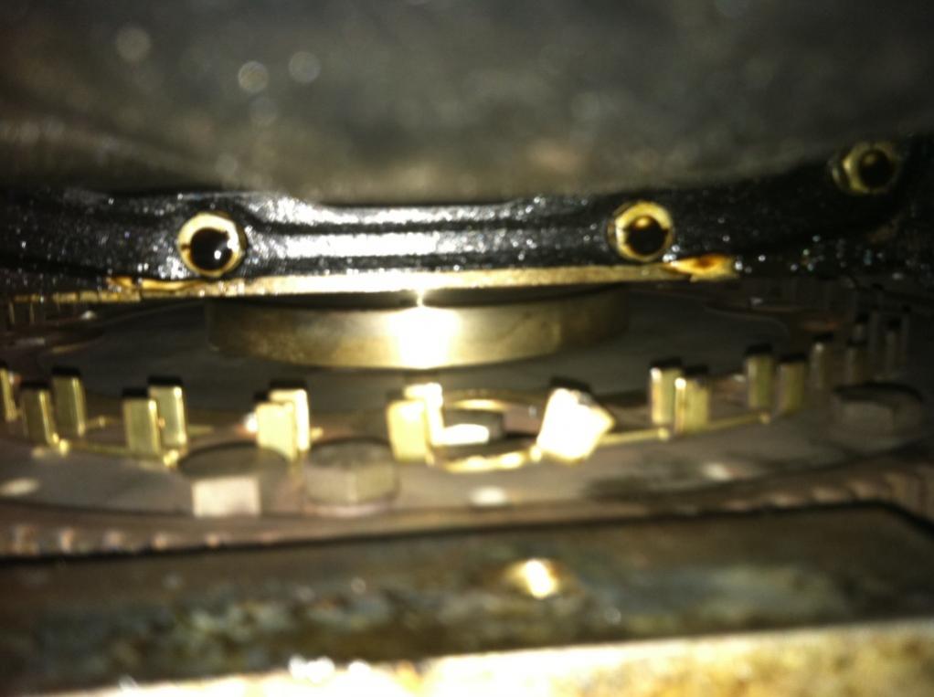

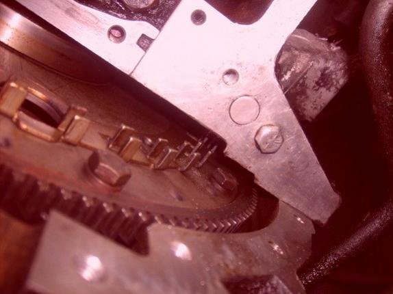

a single cylinder misfire code sets at about a 2% misfire rate, the cat level damage on sets when misfire at 15% is detected. Here's pix of the tabs mentioned.
Attached Thumbnails p38 Check Engine Light + P1314 + weird freeze frame data-reluctor-3.jpg   p38 Check Engine Light + P1314 + weird freeze frame data-reluctor-2.jpg
