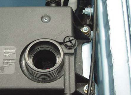

Were is the coolant reservoir located?

Fuses I mentioned are under dash. Regardless of model, usuaully there are multiple fuses for complex things like HVAC.
coolant bottle looks like this
