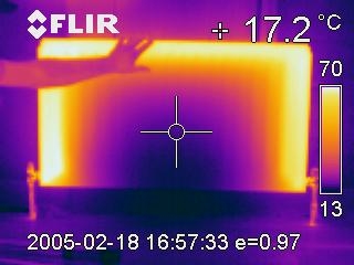

For anyone else checking for the overheat problem, my radiator was %60 blocked and undetectable with internal camera only giving top 3 inches or so. Both end plates were completely clear. My mechanic (Belmont Motor Repairs) just got stubborn and found it by removing the radiator completely, 2000 km now and not a sign of overheating. For all intents and purposes this read like a cracked block/liner problem except there was no coolant loss. Only boiling coolant. Took a lot of advice from this forum and the good people in it and a bloody good mechanic .Hope this helps someone else. Harry
Old Nov 26, 2012 | 07:02 AM
Posts: 16,322
From: Savannah Georgia
Great to hear. Here's a pix of a sludged radiator (demonstration). Hot on top, cool on bottom, because low flow on bottom. If sludge is high enough (more rows involved), it can also reduce the temp of air coming out of the rad that hits the face of the fan clutch. Then the clutch never warms up to re-couple and engage more fully, stays on low power setting, and overheat is even worse. When guys pour in the Leakz Stopz, it binds with the calcium buildup and closes off even more of the radiator. IMHO the practice of ten year or 150,000 mile coolant, spread across multiple owners, Iffy Lube top off, and lack of maintenance just adds to the problem.
