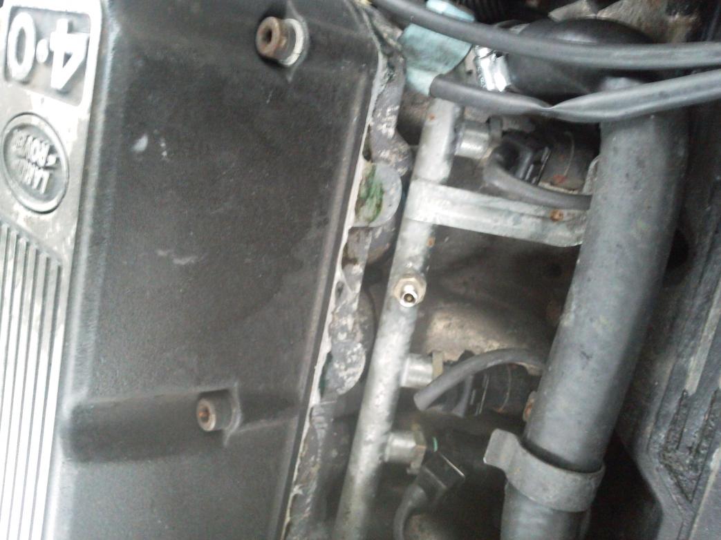

Is this the vacuum line? where the small black twist off **** is located at?

No, that is the fuel rail. The black twist off **** allows you to put a pressure gauge on the system for diagnostics. I believe the vacuum lines are the two black hoses that go from the intake to the valve covers.

oh ok. lucky i didnt do the anything to it. i was planning on doing the seafoam treatment but wasnt sure where the vacuum line was.

vac line is on the back of the throttlebody area, bunch of rubber hoses running out, passenger side, middle top of motor.
