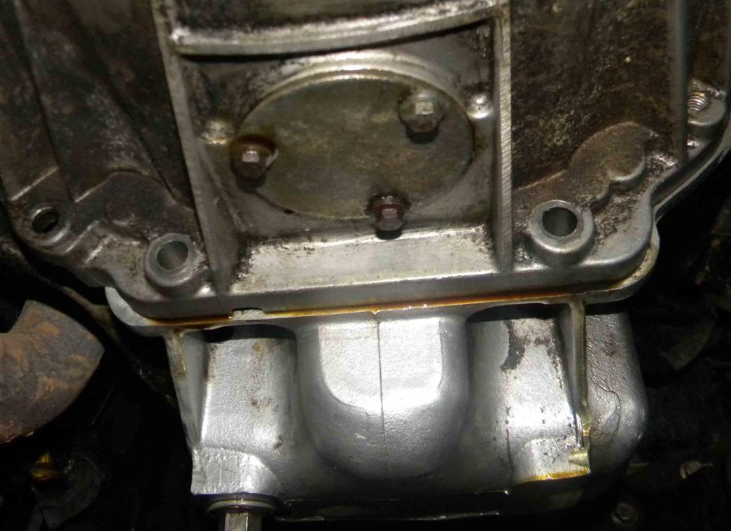

Backed out of the driveway and went on my way. Came out of target and something inside me told me to look under the Disco to make sure everything was good....and to my shock a small puddle of oil. At first I thought it was from a prior car but didn't want to risk it...So I crawled under to see oil dripping heavily from the bottom side of the block (around where the motor meets the tranny) I checked the oil levels and there was still pretty much in there so I busted *** to get it home to get a better look...WOW, my *** is sore from the intense butt clinching ride home. No oil light warning and drove (and sounded) completely normal! Got it home and notcied yet another small puddle of oil where it was sitting earlier and a trail from when I left. I only drove a few miles both ways but am pretty sure a steady stream was present. Once in the garage, I crawled underneath to get a better look...wiped off the areas of concern and think I have pin pointed the area of the leak. The top side of the engine looks normal and dry for the most part. And I am pretty confident that the oil is leaking from the area mentioned above (pictures attached) Not exactly sure the LR terminology for this area..LOL.

**update...in the picture provided above, should there be (2) bolts in the area that there are none? Even looks like previous gunk built up around where the bolt heads would have been...could this be a potential cause for my leak?? If so, would these bolts have been removed to gain access the drive shaft repair that was recently done?

Hi, Just saw your picture. Not much a technical guy, I have same model as yours. Seems like there is something is missing in that picture.
BTW! Just checked mine and crawled under the truck, YES! There is something missing! 2 BOLTS!!!!! Ouch! - Gerry

UPDATE! Sorry its not 2 but 3. There should be another on the top far right thread sticking out. Hope you get your truck towed. Your thing might fall on the ground! - Gerry

After talking to a few people, they too confirmed that the bolts are missing! There are (2) front facing bolts that are DEF missing and (1) of the (4) rear facing bolts that I can see. Now the hard part is finding the bolts. I can't find their specs (thread type or length) Once I find them, I will torque them back into place and add some more oil and see what happens....Its just really weird that they are missing? I have been told that these bolts are in no way related to my recent front drive shaft replacement as first thought....
