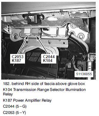

Subs have their own (very weak) amplifier. If all other speakers produce absolutely no sound I'd look first at the main amp in the passenger kick panel. First thing to do is check fuses, in particular F3 (main), F12 & F13 (main), and F4 (sat 2...bottom row). There is also a relay behind the glove box (K187).

I Checked the fuses, all good. I checked behind the kick panel, AMP fuse good and unplugged and plugged the relay (seems to be in good shape. Took apart subwoofer, definitely needs to be replaced but shouldn't be affecting the other speakers. No solution yet. Could it be the head unit/Radio it self?
