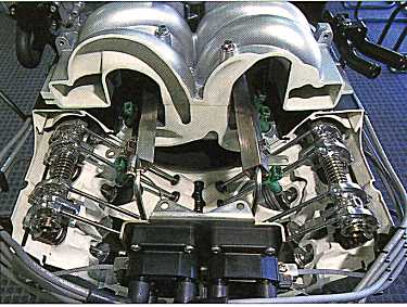

1. P1884 is one of those codes that shows one thing to a basic scanner and has many sub-codes that show up to a dealership level scanner (not at a auto parts store). Attached is page with tranny codes from RAVE shop manual. First thing is be sure you have a great condition battery verified by voltage readings while running and while not running with a modest load like head lights. Tranny ECU loves to whine about battery volts.
2. Any coolant loss? Overheating? White smoke out tail pipe? Plugs look steam cleaned? Head gasket or worse....
3. Replace CPU and you will invoke other issues with being synced to BCU, would replace them as a set from same donor vehicle.
4. See attached for plug wire layout.
5. When clearing the 300 codes, they may come back in two drive cycles. System likes to store them and see if they happen two days in a row.
6. SWMBO - jewelry usually works
Images attached
